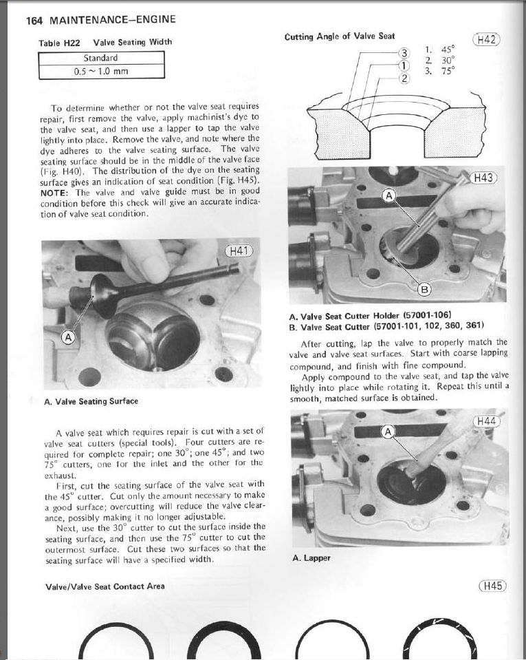

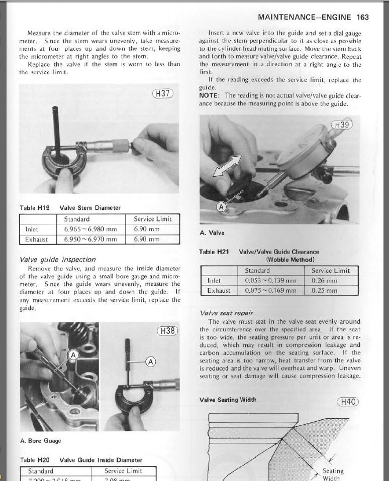

www.kz400.com/WorkshopManFrameset-5.html
www.kz400.com/Workshop%20manual%20bilder...0man.%20p156-170.pdf

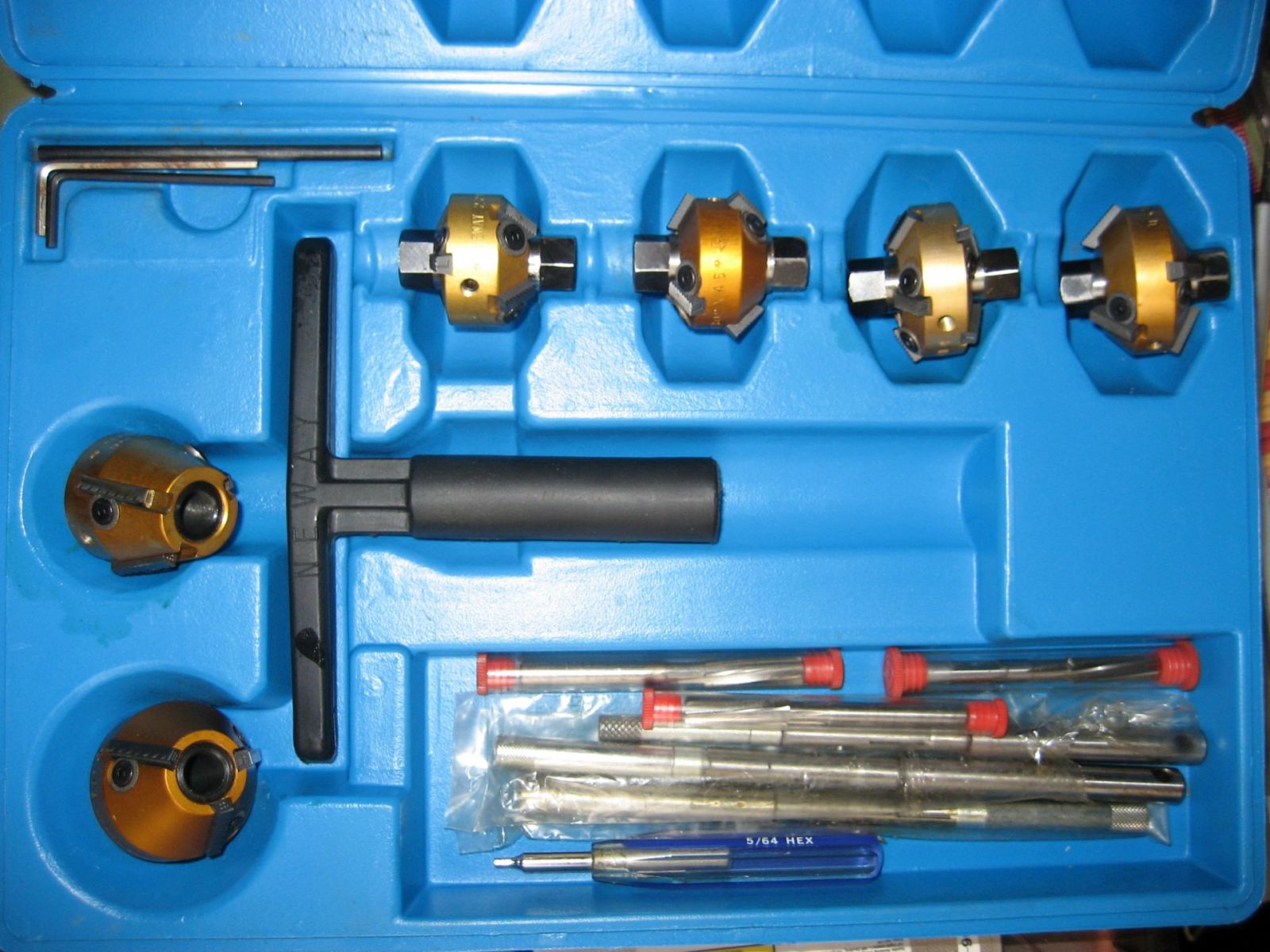

This is the tool i use for resurface valve seats.
