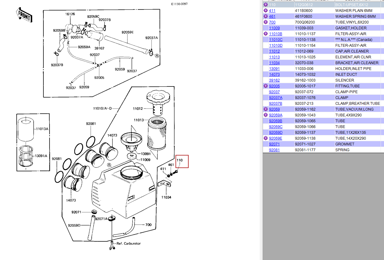

If your bike is the LTD I'd bet that it wouldn't bee too difficult to fit a stock exhaust system from another KZ 750 model. Better yet would be to find someone locally who has another KZ750 to see if it's any quieter.
My bet is that going quieter than stock is impossible. Keep in mind that another source of engine sound is the intake opening at the air box. Does your bike have the original intake baffle?
Bill

Re: Quiet pipes?
09 Nov 2016 09:21
Supertrapp makes mufflers that are tunable. That is, you you install fewer or more disks at the outlet. Mostly it's for adjusting the fuel air mixture. Fewer disks enriches and more disks leans it out. As a side effect fewer disks also makes it quieter. Probably stands to reason that a 2 into 2 system would be quieter than a 2 into 1 on account of having twice as much muffler.

Re: Quiet pipes?
09 Nov 2016 10:37 - 09 Nov 2016 10:38
I built a stealth 2 stroke MX bike. Fab'd a flowmaster style silencer insert, wrapped the expansion chamber with header wrap and installed a pipe guard. The header wrap made a pretty big difference because alot of sound resonates through the pipe not just out the back end.
You'll also get intake noise too.
