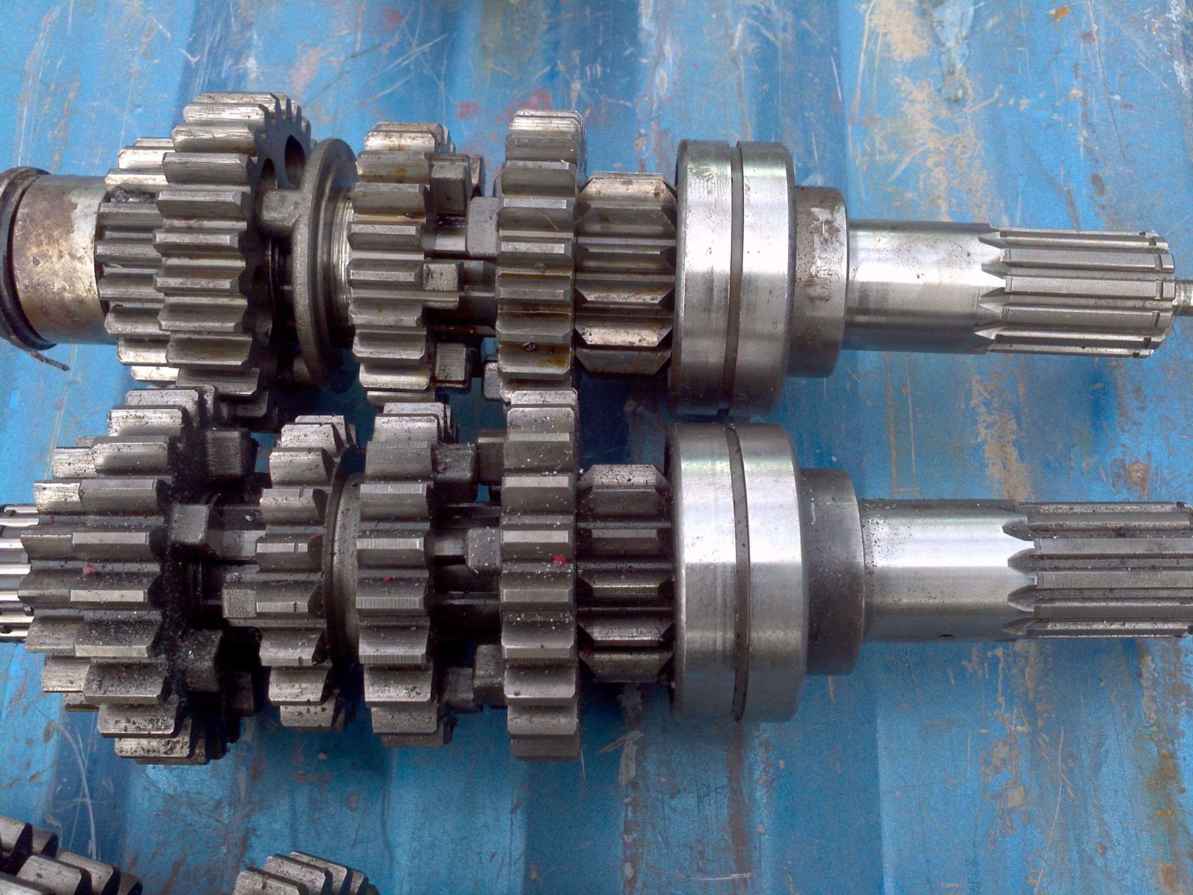

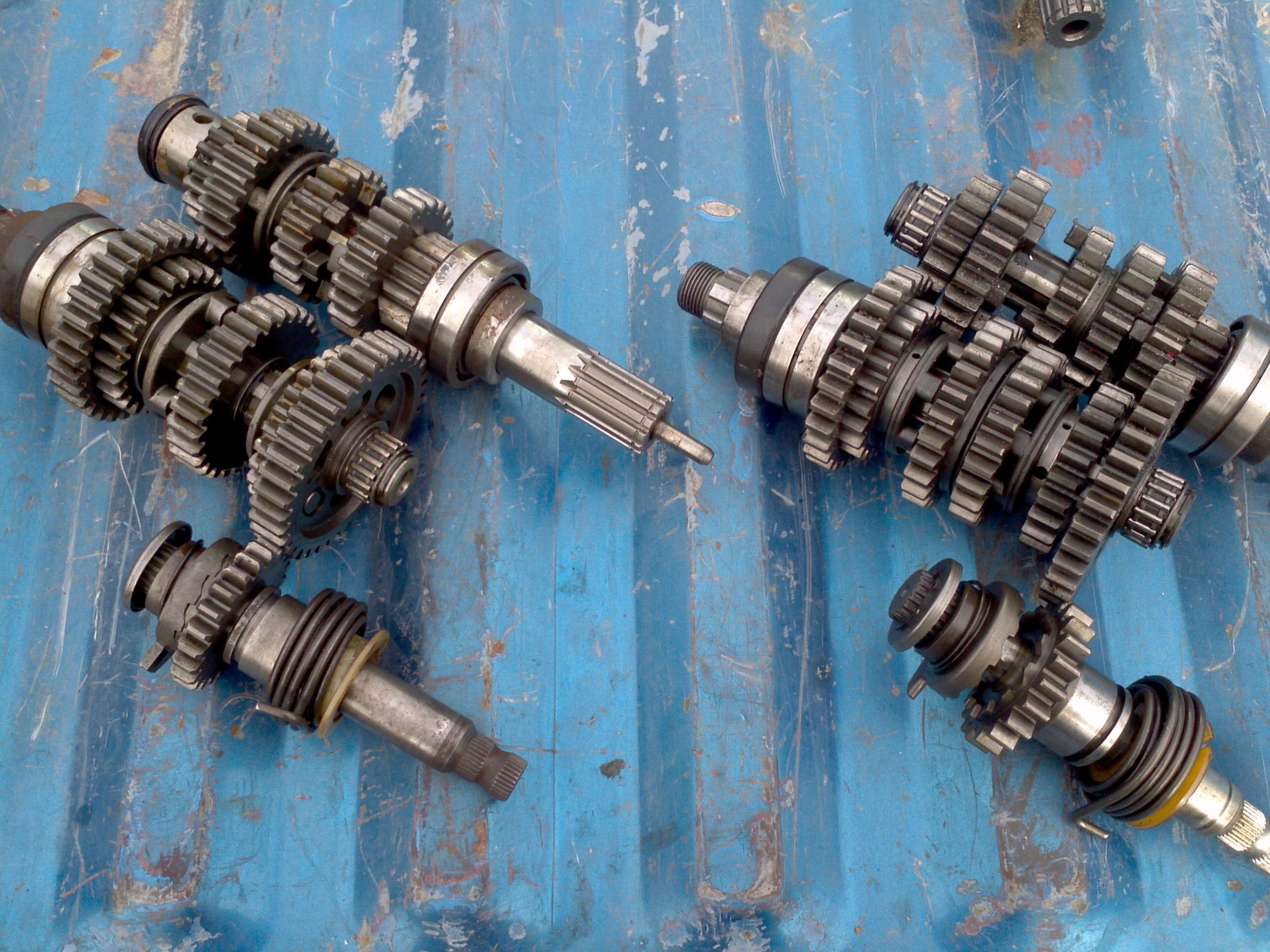

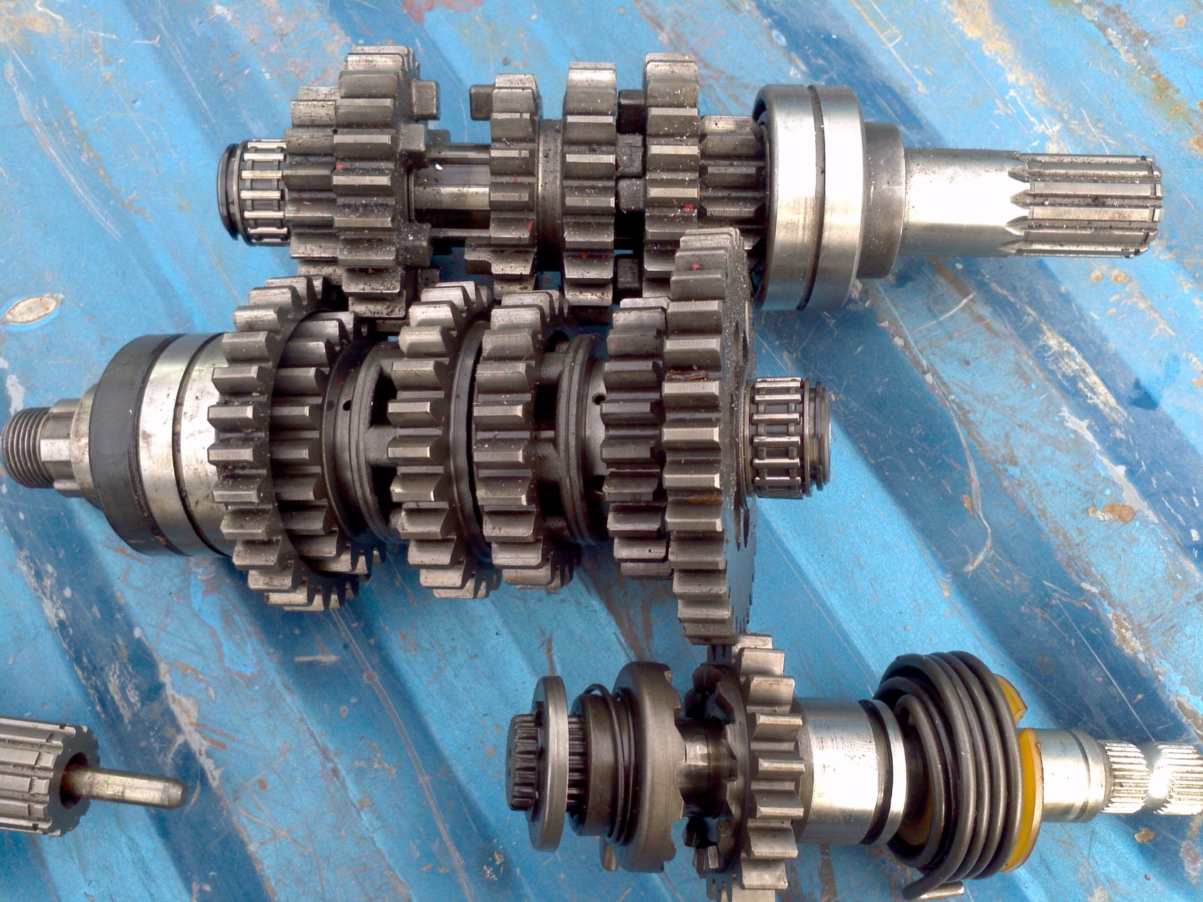

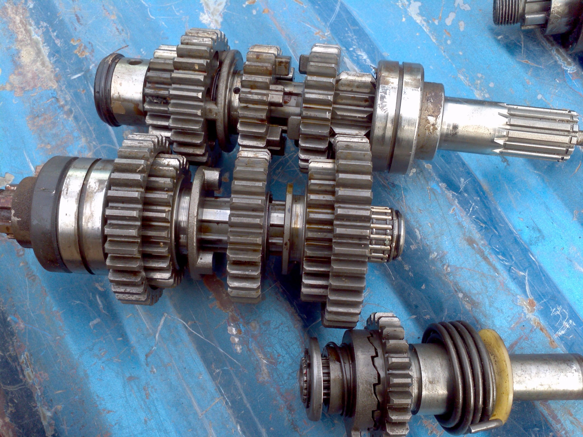

Here is a pick of an early KZ400 gear set on the left and a late KZ400 gear set on the right.
It has been about 10 years since I did this modification to my 440. The late 400
gear is hard to come by and can be pricey also. I didn't want to pay that much at the time so I
used the early 400 parts on my 440. The shafts are the same size and spine so the gears will swap.
The drive gear for first is wider and has to be narrowed. The counter shaft gear can be used as is.
But the dogs on the 6 speed that engages the counter shafts first gear have to be machined on the
side that is closest to the shaft to fit the early first gear.

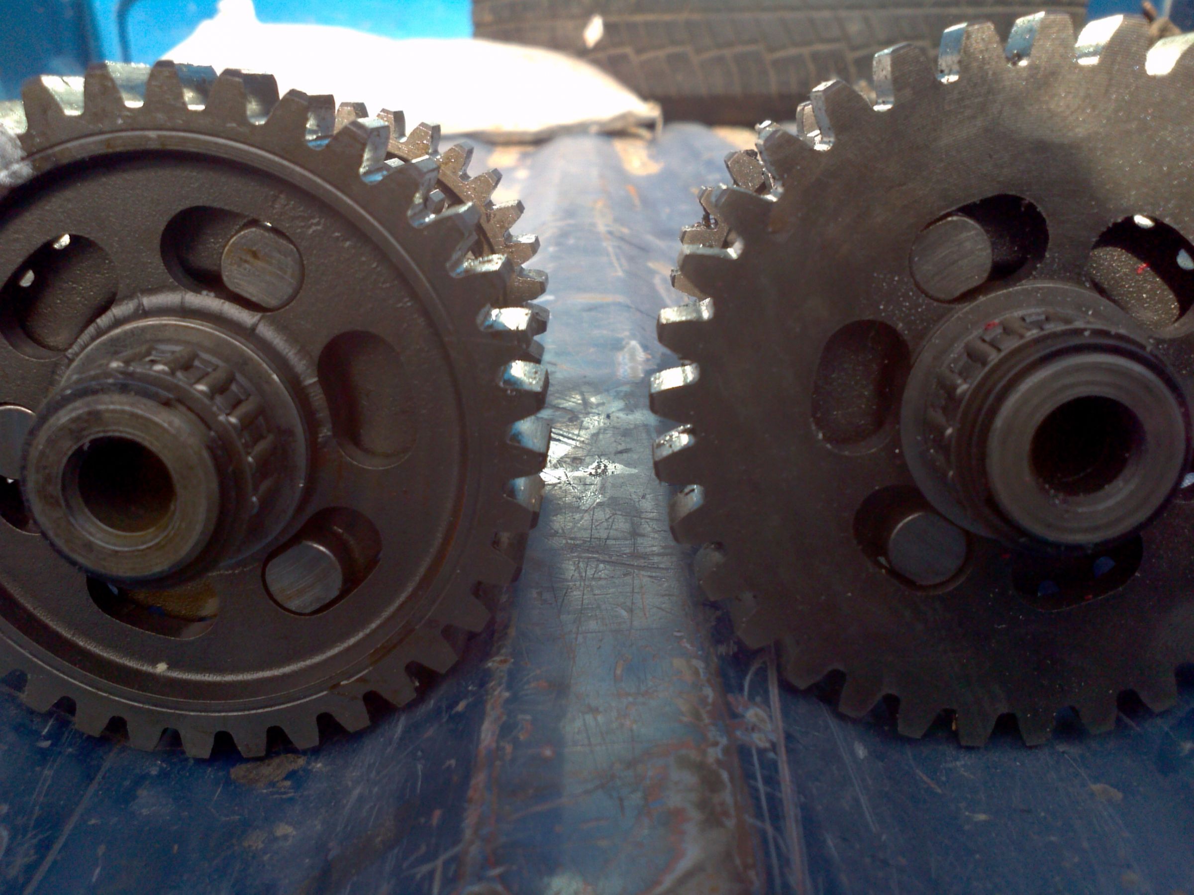

The 400 has 23 teeth on the kick shaft gear.
The 440 has 20 teeth.
The 400 [on top] has a wider drive for first than the 440.
And a pic of the dogs.
Hope this helps.
