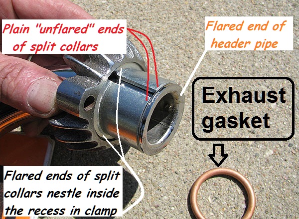

Quick question on the same cylinder that I have oil and exhaust leak is a sleeve. When the motor is running I can see it vibrate is this a part that will need replacing or will a new exhaust gasket fix this problem

Split collar might be loose for whatever reason, or maybe installed backward.
Maybe the gasket is missing; or perhaps a new gasket is needed.

So the collar doesn't actually come in contact with the crush ring so I probably need a new one I've tried tightening the clamp thinking maybe it wasn't tight but it is good and tight thanks for the info
