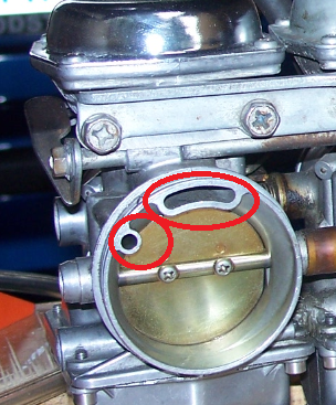

Some cheap pods have an internal lip which can block the airjets (circled in red in the pic below) on the Keihin CV carbs causing problems
K&N pods dont.
I have used the same jetting as you when I had the K&N pods without problems
