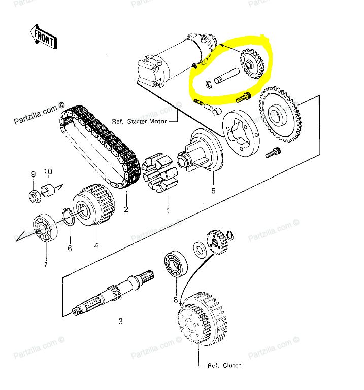

Newbie here. I started re-building a basket case from a bare
frame up. Ready to bolt engine halves together but I think something is missing. There are 2 bosses inside with a through hole in the case next to it. I attached a picture. Hope someone can help. Thanks in advance.

Secondary shaft and starter clutch. Sounds like you need a factory service manual.

Those bosses hold the idler gear for the starter.

That was my guess. I do have the factory service Manuel but it didn't show it. By the way, I tried on another forum, they directed me to you.
Thanks Nessism and I will be asking for your help again I am sure.
