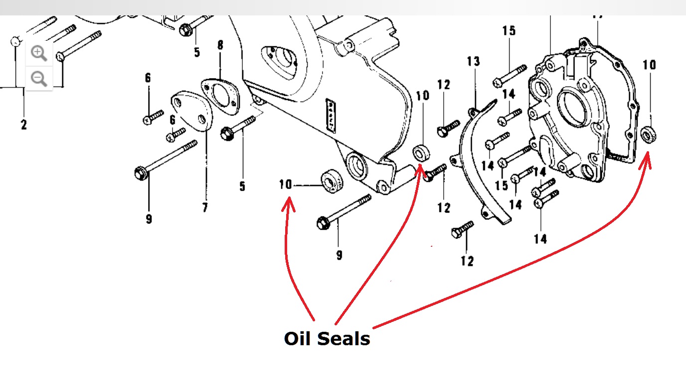

Came off a seal?

04 Aug 2016 21:42 - 05 Aug 2016 05:45I don't know whether or not this seal is the type that contains a spring.
I believe such springs are intended to produce a tighter grip by the inner diameter of the seal onto whatever component fits through the seal.
The part number for this particular seal is 92051-005.

Thanks for the quick response, most likely from one of the seals now that I know there is one inside. Will check tomorrow.
