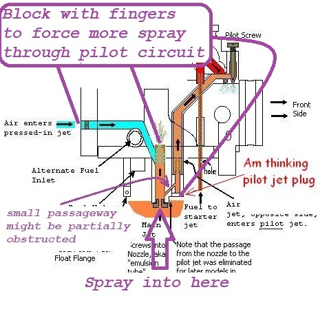

Compression seems okay.
With plugs removed, are there healthy fat blue sparks?
Sounds like imperfect carb primary circuits.
Carb cleaner sprayed through the pilot jet should visibly exit into the carb bore.
Assuming that the float bowls are all filling with gasoline as they are supposed to, and that the fuel levels are correct as evidenced by clear tube testing, the pilot jet must receive gasoline, and the gasoline must get through the pilot circuit, past the pilot adjustment screw (where the gasoline is mixed with air to form the fuel mixture), and through orifices into the main carb bore.
Here's a diagram that could be helpful even if not an identical CV carb.
Good Fortune! :)

I am hoping it is not a fuel problem as I abhor taking these carbs off the bike. They were cleaned recently but it did sit for some time with E10. I will look into the clear tube testing, although if I have to take the carbs off again I would just as quickly swap in a suitable setup with mechanical slides. I don't like the idea of air pressure doing the work that my wrist can do!! :side: After I exhaust my other options that is where I'm headed. Hopefully we don't have to go there. Could the air bleed for the pilot circuit be clogged?The plugs are pretty dark maybe its running rich at low speed?
