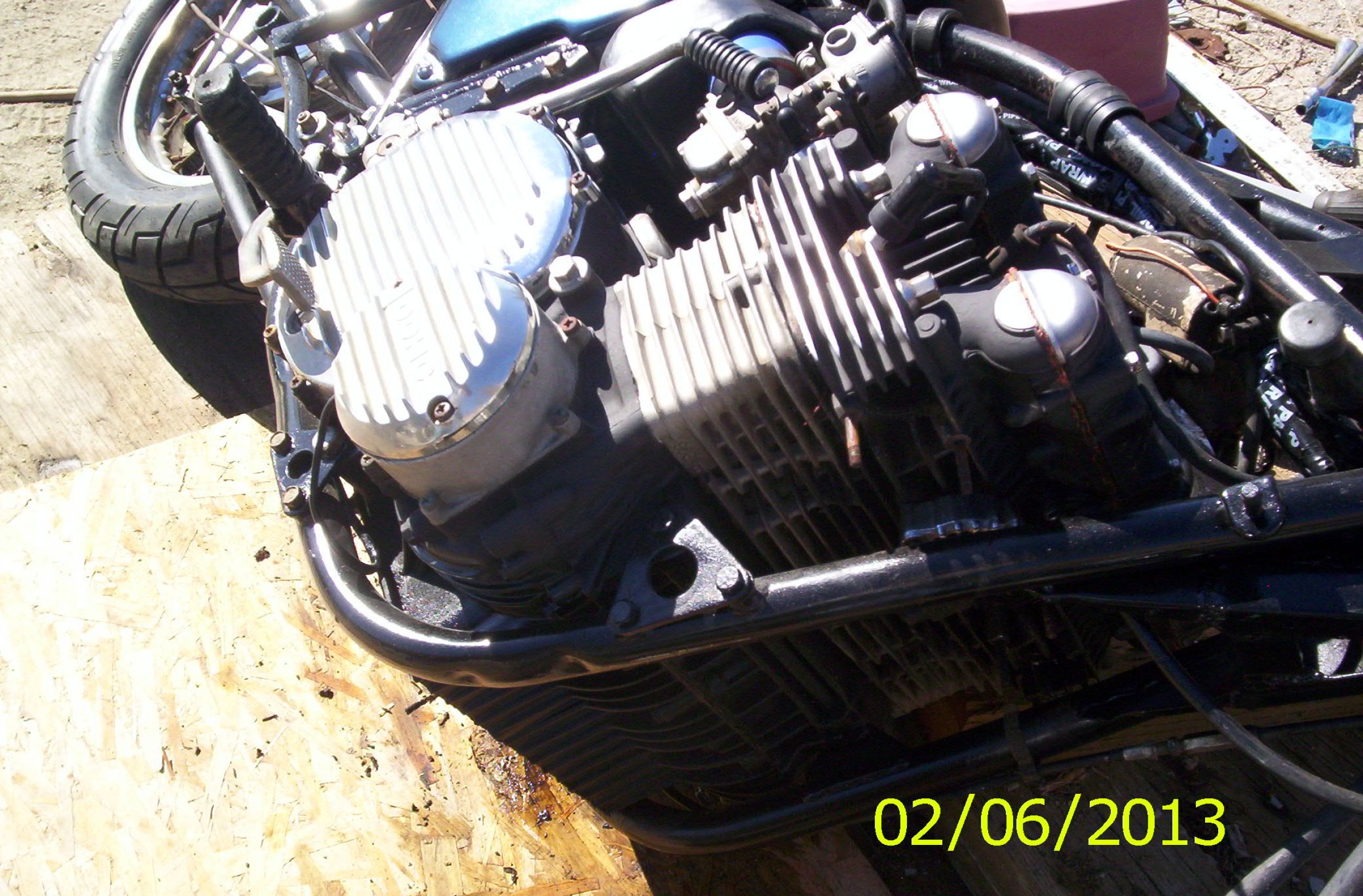

The bike can be lain on it's side with blocks supporting the alternator cover. A snug fitting socket is a must however it's done. The impact pushes down and turns the bolt at the same time. It's the shock that frees the threads.
The pan can be removed if it still won't come off.

Note fuel tank is and should be removed before laying bike on its side.
Also a good idea to remove the battery, especially if it has removable filler caps that would allow the fluid to leak out when leaned over.
