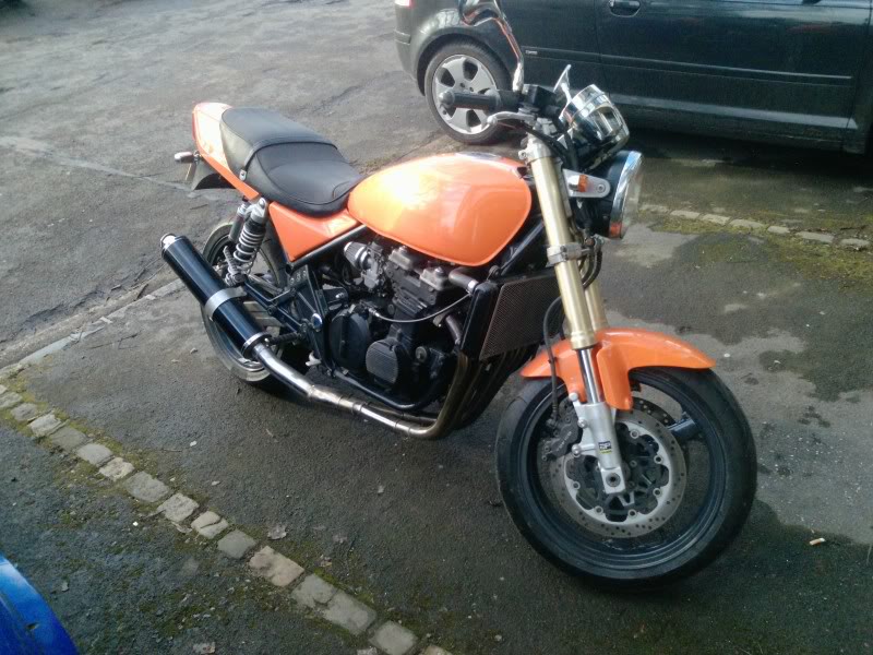

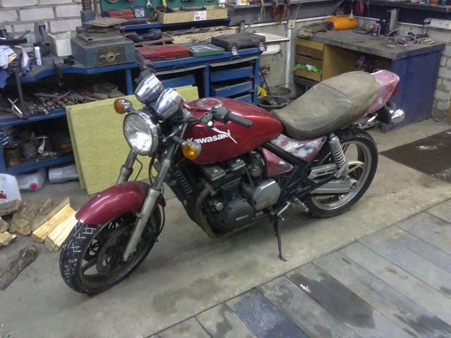

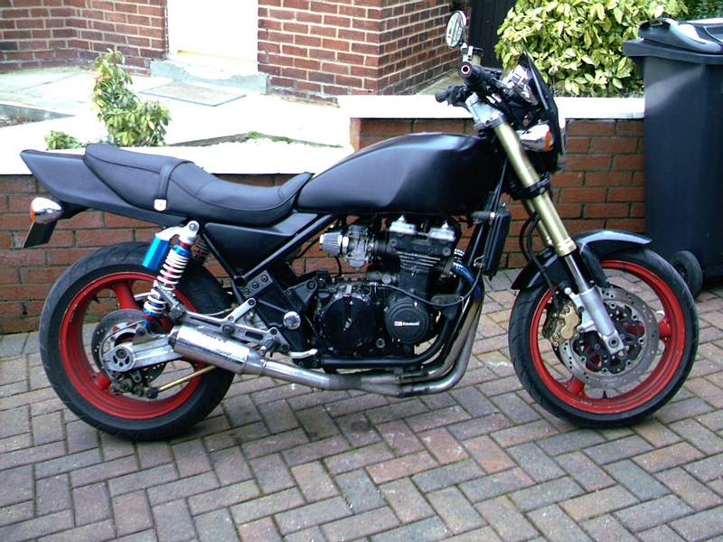

There are a handful of people that have swapped zx600 motors into Zephyr zr550's. The zr550 and kz/gpz550 motors cases and mounting points are identical. The zx600a/b/c motors cases will fit in a gpz/kz/zr550 frame only after making new mounting brackets to tie the motor to the frame mounting points.
But......all the guys who have done this live in the UK where it is cool enough that they can get away with not running any cooling fans on the radiator and still not over heat. And.....the zx600 models over there don't come with oil coolers (because of the colder climate) unlike the US models and there is NOT enough room on the gpz550 frame to mount both the radiator, cooling fans and a oil cooler around the exhaust manifold on the front and not still not interfere with the front fender or tire. Plus you will also need the zx600 wiring harness and ECU from the zx600 as well as the carbs. The gpz550 carbs will be to small and will also not have the correct spacing anyways. But the 550 exhaust will bolt right up, so theres that.

Thanks a lot for the info and pic Daftrusty! I'd be getting the whole bike in running condition so sourcing all the extra bits wouldn't be a problem. That picture though is exactly what I wanted to see. I just don't like having the radiator sitting out there like that. I suppose I could have a custom core made or find one but the power improvement (58hp to 75hp factory ratings) probably isn't worth all that trouble.

Ohhhhh...If you can get the whole bike with all the ignition bits, carbs and radiators, then that is half the battle right there. I really really wanted to try doing this to my zr550, as they are de-tuned kz550 motors, so there is even less HP to start with. I eventually installed zx550 pistons and cams in my Zephyr to bump up the HP.
So I would like to live vicariously through you, and see you tackle this project.
You could try and see if you could fit the oil cooler remotely back by the battery box, as some guys on here have done with their project bikes. There would have plenty of room if you didn't end up using the stock airbox. ( but that also means the horror of trying to tune CV carbs with pod filters.) So many cool problems to solve. If it was me, and I had a whole running zx600 to try it with, I would definitely do it!!
A couple more pictures I found. (Not mine)
