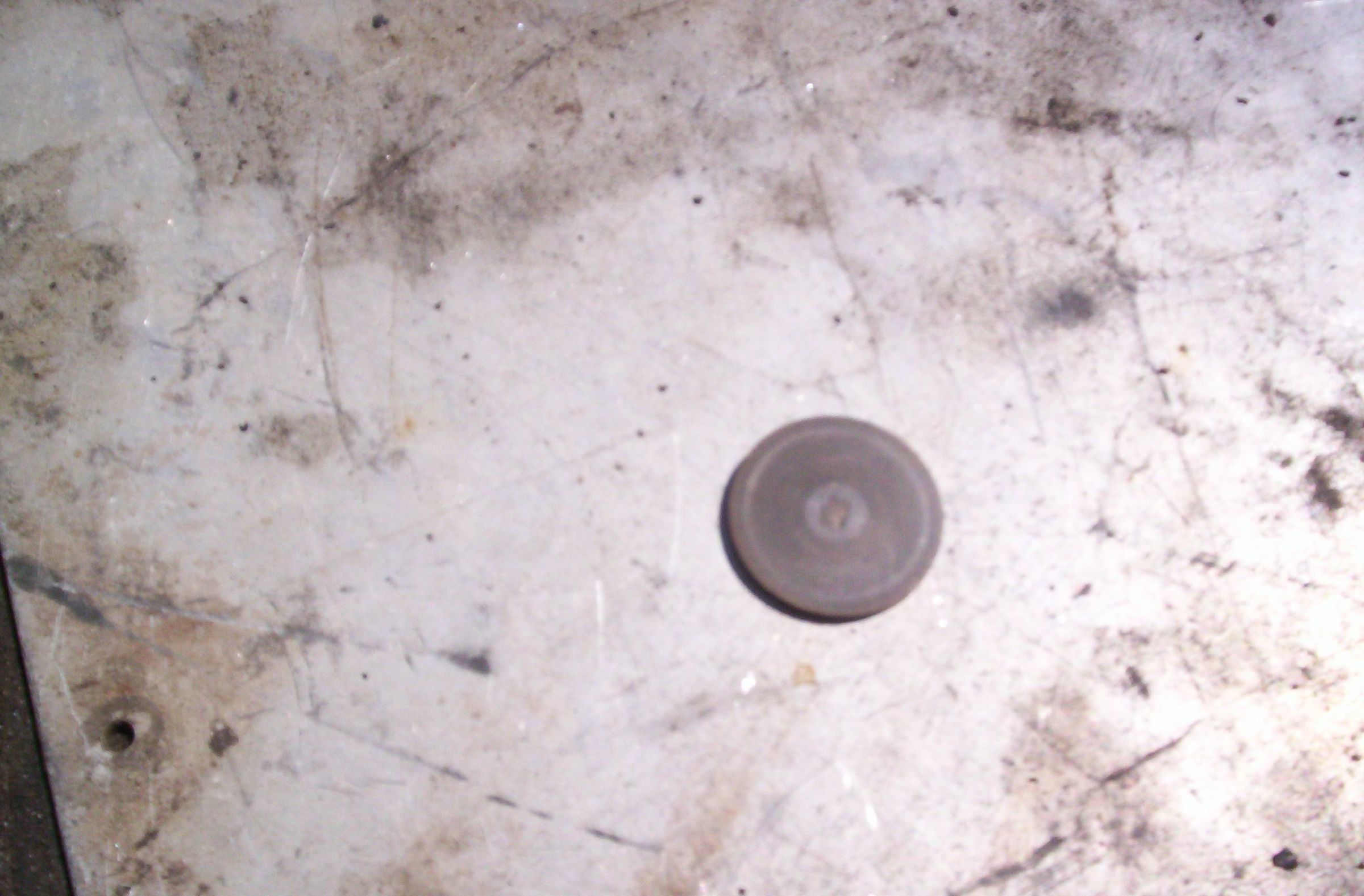

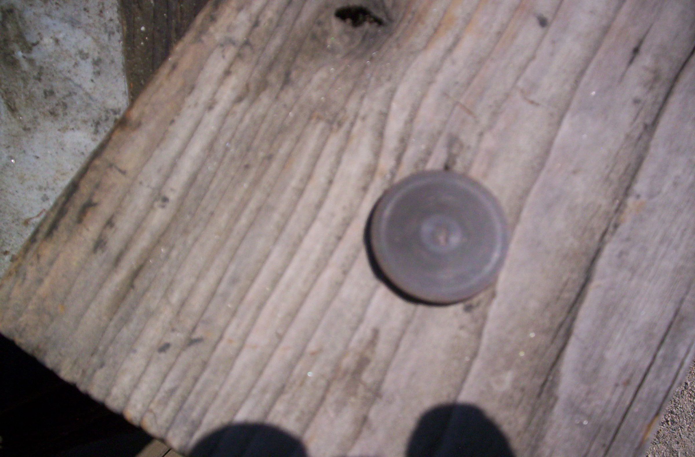

Killing time waiting for a new Wiseco head gasket and to decide on what to do with the cam shaft with mildly galled cam lobes.... and those two Chinese 240 shims that are also galled up ... which I still think is the real culprit in this galled up cam lobe issue.
