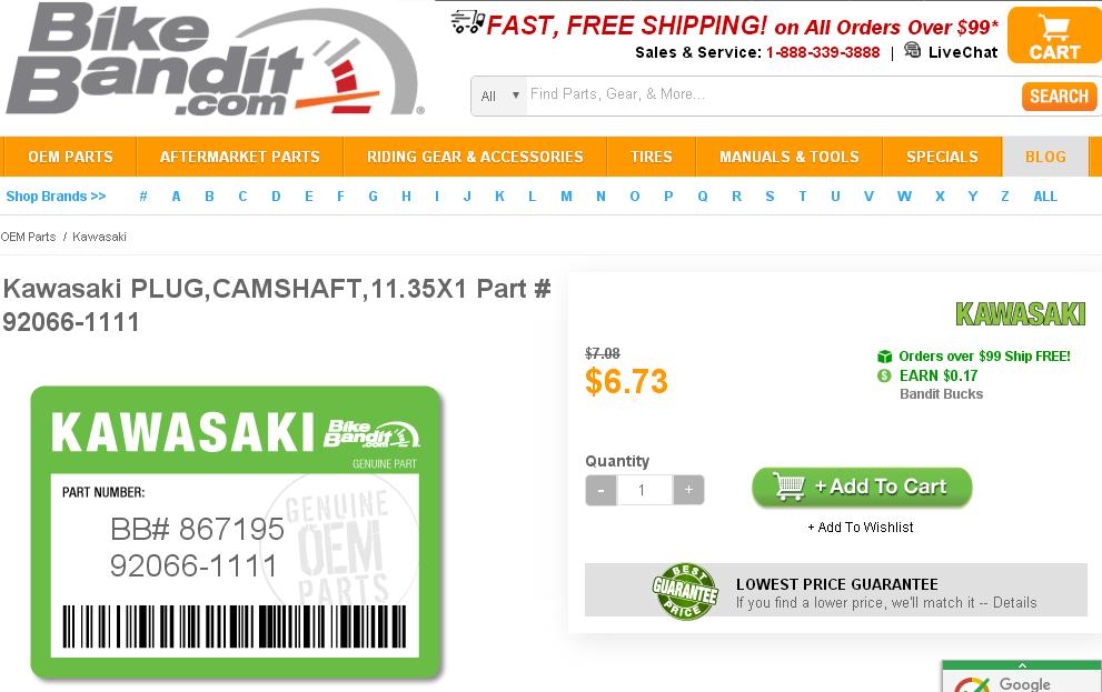

Also, is there a way to tell if Partzilla is selling an aftermarket part instead of a genuine OEM part?
I don't think I've dealt with them before.
(Z1 Enterprises explicitly says they are selling an "equivalent" of the OEM part, as in an aftermarket part.)

I hope "Genuine OEM Parts" means genuine OEM parts.

With Bike Bandit they have an OEM parts ordering method and aftermarket. They don't mix and match.
BTW, if you clean the old parts well and use silicone on the curved portion that fits into the head you can reuse the old plugs. Even if you purchase new plugs you should still seal them where they fit into the head if you value oil tightness.
