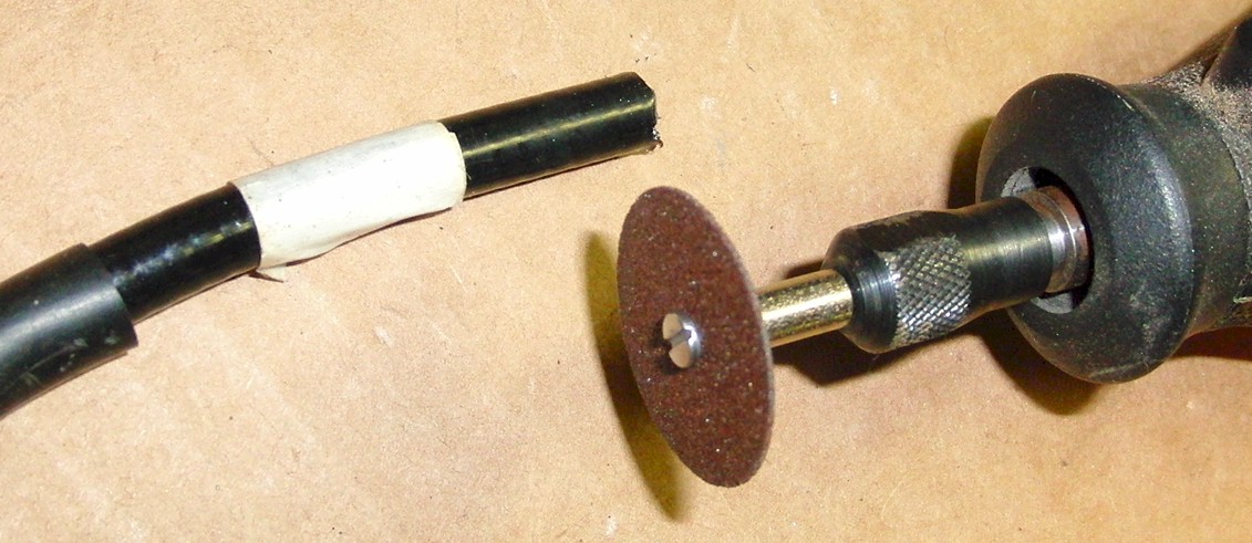

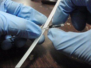

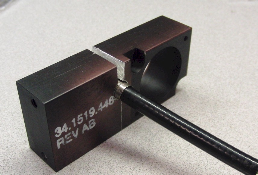

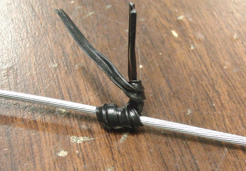

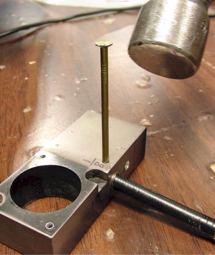

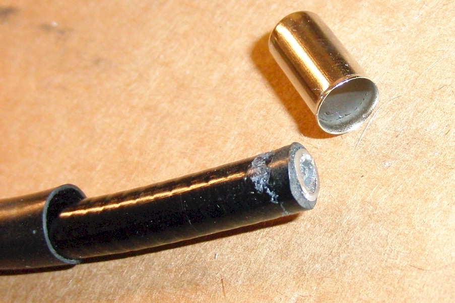

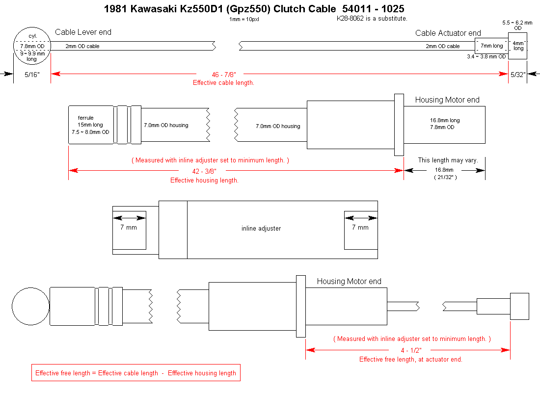

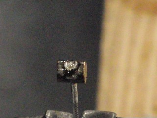

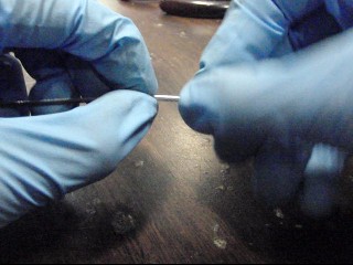

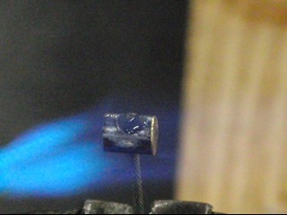

This diagram is specifically for the 1981 Kz550D1 Gpz. 54011-1025 clutch cable and the aftermarket substitute K28-8062 cable.
Other Kz550's will have different overall length, but the free-length measurement should be the same.
The red dimensions are the important ones when making a new cable.
REMEMBER: The cable must also go through the lever end barrel (about an extra 5/16"), so make sure it is included when you cut!!!! Too long is ok. Too short is a disaster.
Open this image in a new tab to see it clearly.
These measurements are sort of an average from several different cables. Your measurements might vary +/- 1/8" or so.
