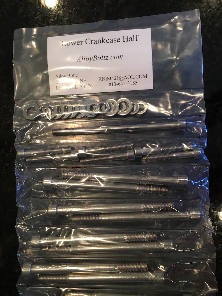

I also have a set from a company called Alloyboltz and they are stainless steel Hex heads. They came in the set of dress-up engine bolts that I got to replace all the old nasty phillips screws and fasteners.
I would like to know if these are safe to use. Has anybody used these before?? The instructions seem to tell me that since the case is aluminum then I have to use anti-seize. And because of that I can't torque the bolts down to 18ft-lbs like the factory manual instructs, but to only 10.7ft-lbs. They look really nice, but they make me nervous. Like will they stretch and loose torque???

I'm not a big fan of stainless in that application because (typically) the metal isn't as strong as that used in the stock bolts, and you have to use a secondary washer, whereas the stock bolt has a large head with a flange so to speak.

I love stainless and use it nearly everywhere, but for engine crankcase half bolts I would stick with original high tensile steel.
