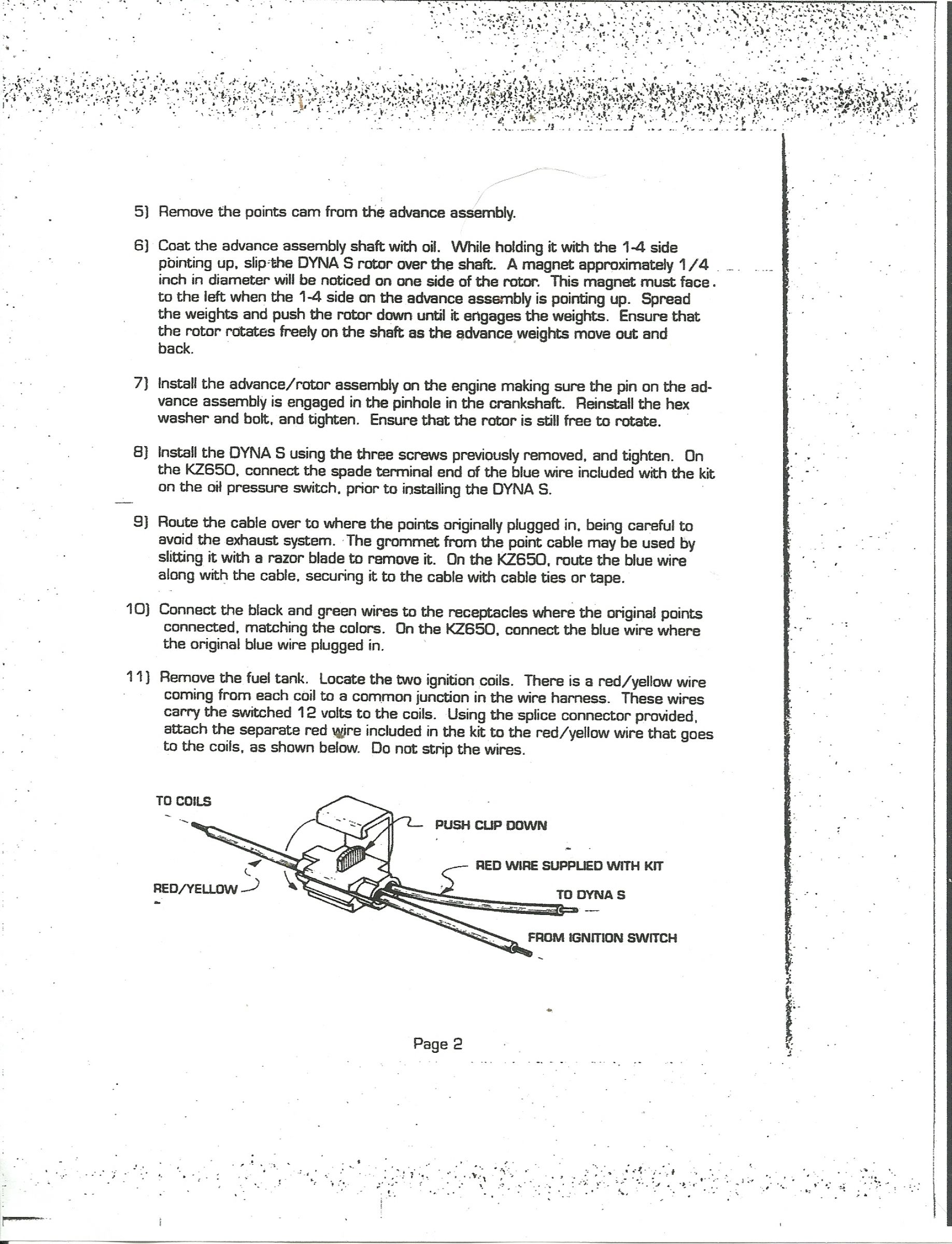

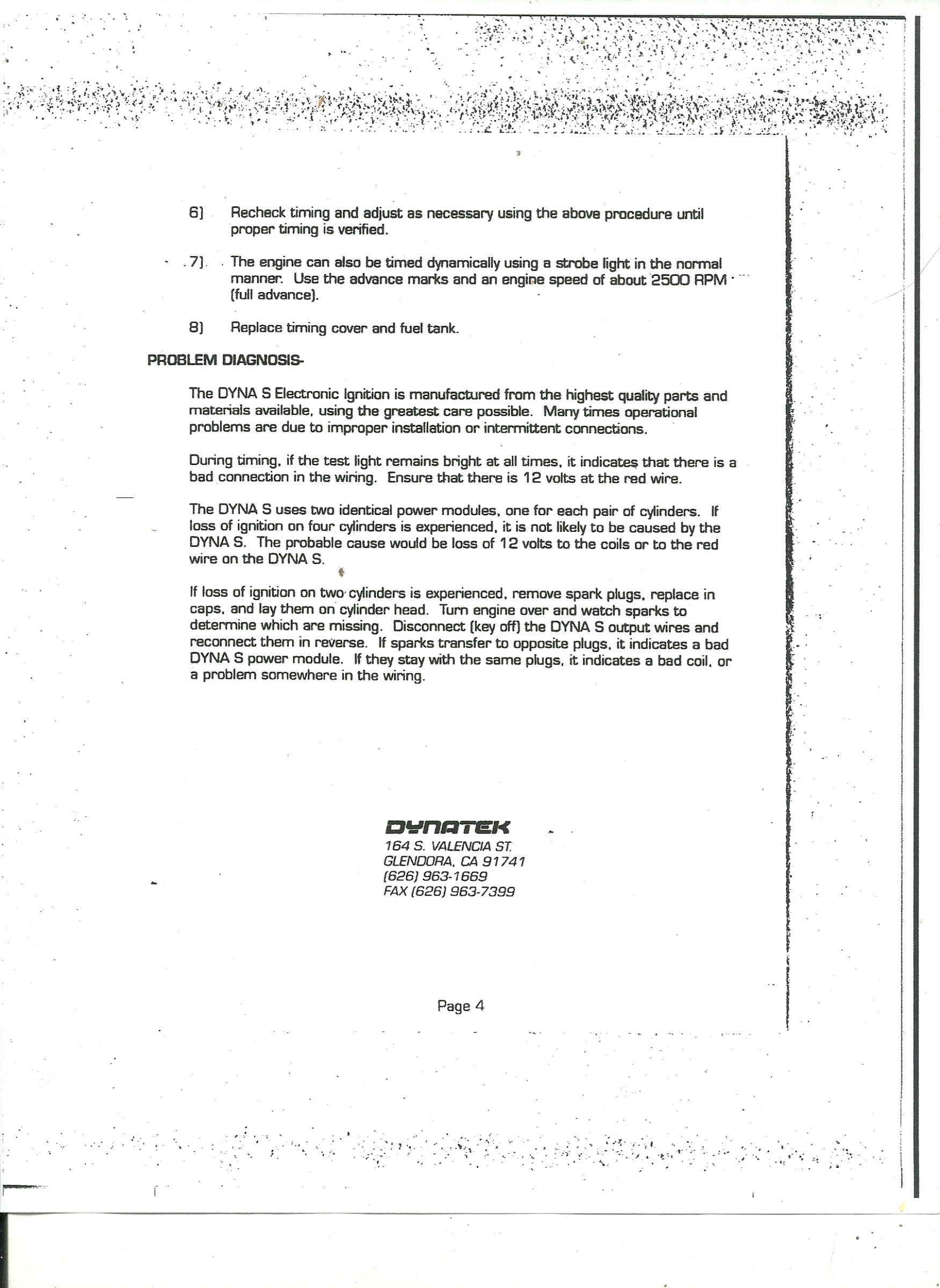

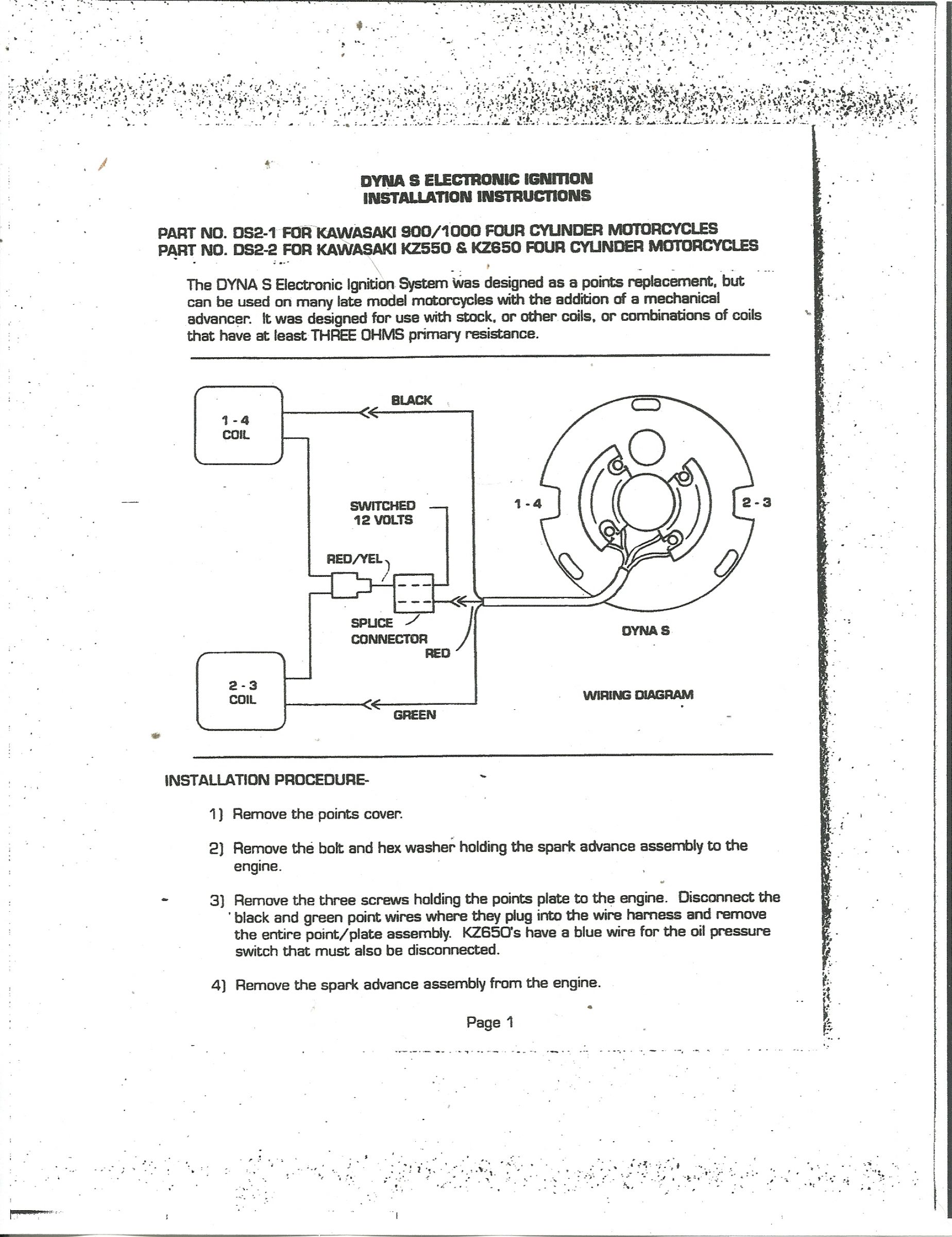

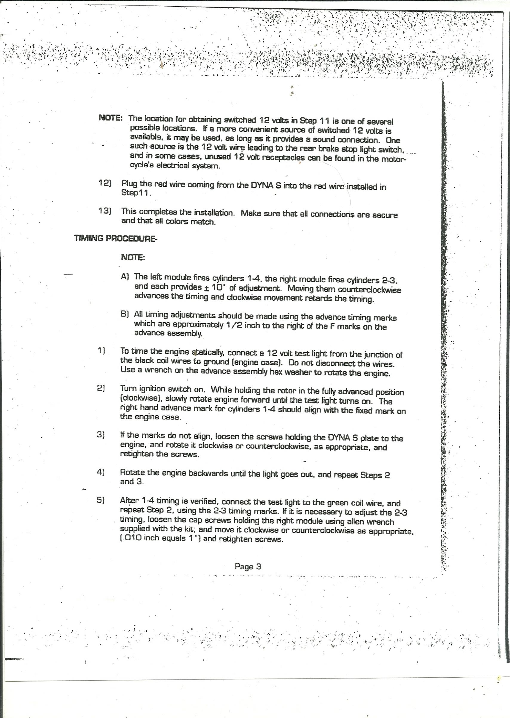

Got a call from one of our members asking how the set the ignition. I thought I had the instructions saved as pics but only had them as PDF. To make it easier, I changed them to pics and am posting them here for easy reference.

The same instructions came with mine. You might want to make sure this gets into the filebase since i don't think this particular doc is in there.
I didn't follow these exactly. Since I put on green coils as well, I used the power off the loom for one of the old coils instead of the rapid splice. I ended up using it to connect one of the coil trigger points to my tach wire.

I made up some pig tails for the Kaw coils and the Dyna's. That way it's plug and play if I have to change them.
