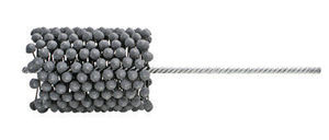

You need a good 45* cross hatch in the cylinders for the rings to seat. Use a bottle brush if they are straight.

You mean a brush with stiff steel wires of about 3 inch dia ? Soory never heard of bottle brushes, not making wine or beer haha
I ll look on eBay or maybe car parts store ?
cheers
cheers

05 Jul 2016 11:14Poudrette wrote: You mean a brush with stiff steel wires of about 3 inch dia ? Soory never heard of bottle brushes, not making wine or beer haha
cheers
www.enginehones.com/
