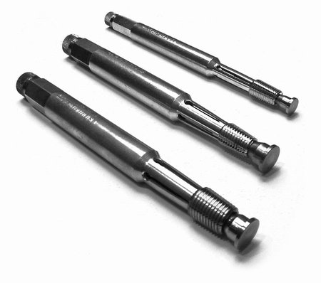

When restoring the threads in a spark plug hole -- To help avoid cross-threading, would use a backtap, aka reverse spark plug tap, which begins at the deep end of the spark plug hole and re-threads upwards.
For more info, click here > www.google.com/?gws_rd=ssl#q=reverse+spark+plug+tap
