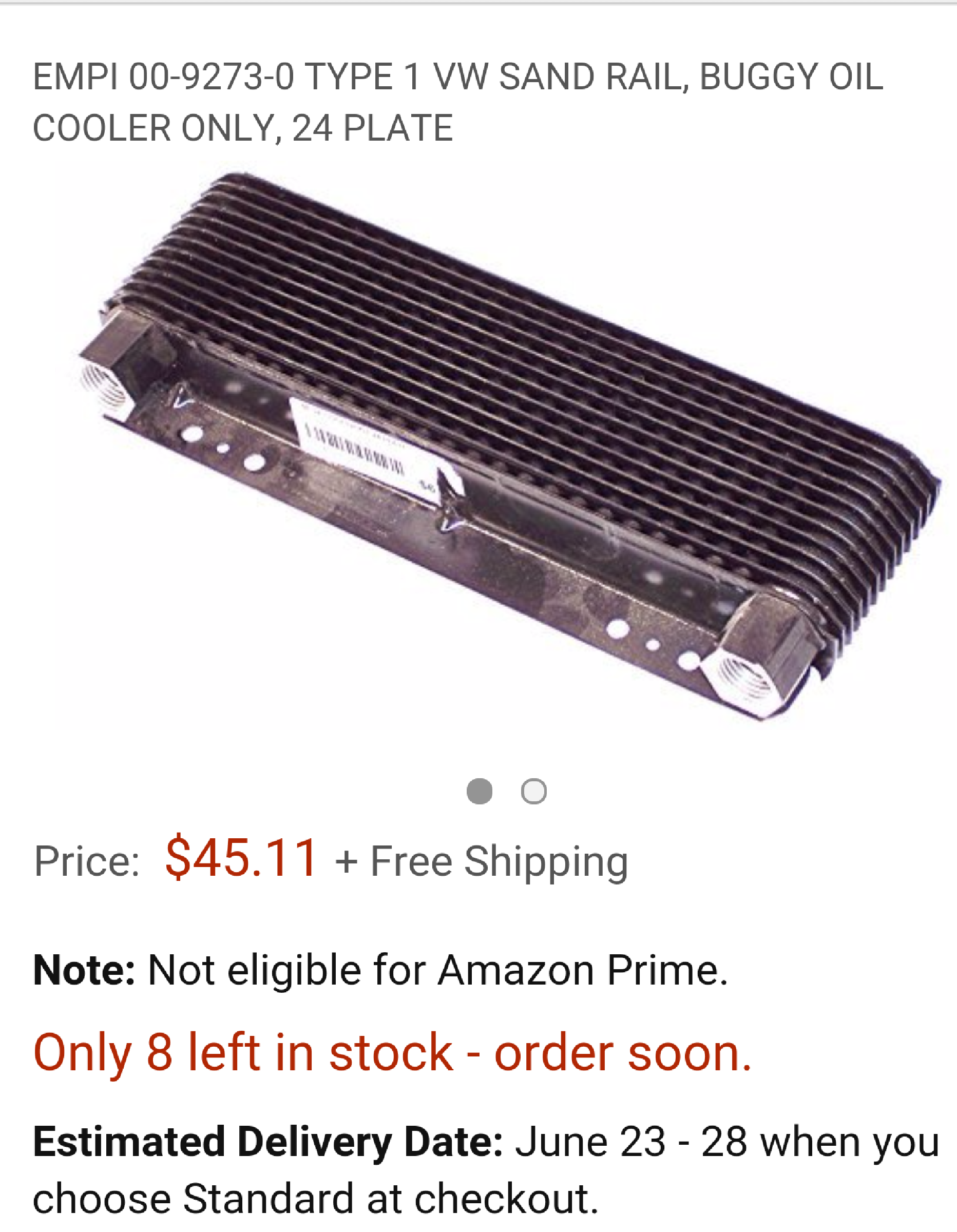

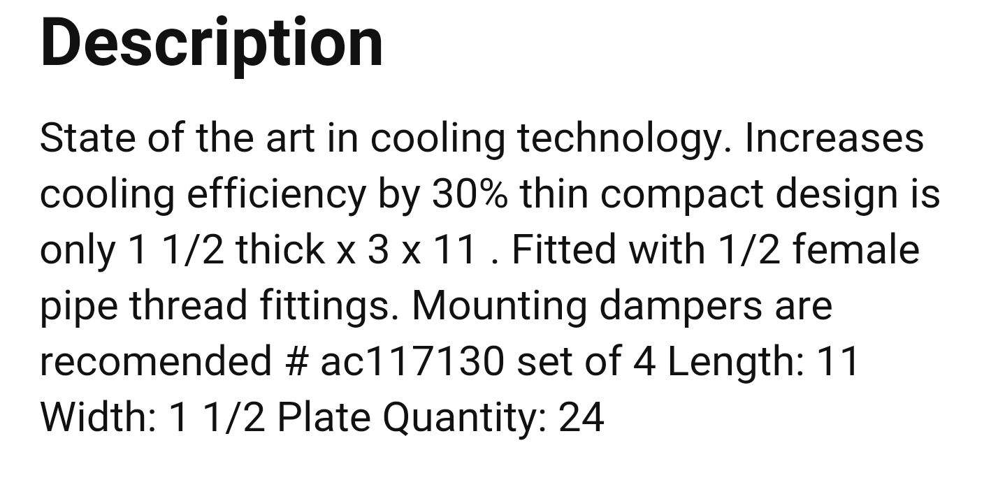

I'm leaning towards this one, based on price and size. My fear is that it will be too wide, but it's short.

I'd take a piece of cardboard, cut to size and see what it looks like.

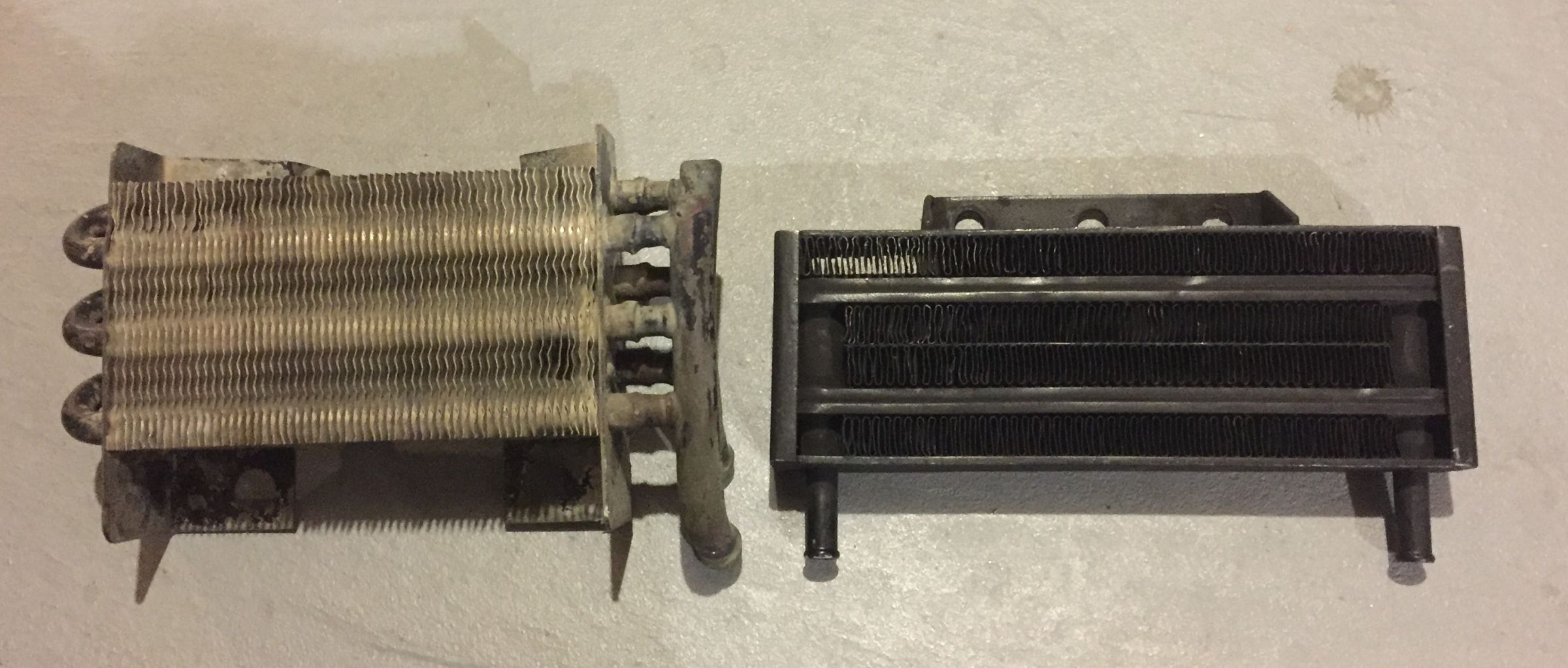

I was holding a Lockhart type oil cooler for someone here for the last couple months... guess he isn't interested in it.
Here it is compared to the KZ one I got from that old KZ1000LTD....

The one on the left is the kind I had in the 80's. UG but it worked. :blink:

Yeah I think yours was pretty smashed up though.
With respect to smashed up coolers, I've combed those fins out before and got them to look respectable... Well, after painting them satin or flat black.

21 Jun 2016 18:17That cooler on the left looks like an automatic transmission fluid cooler. Not a motorcycle part, originally anyway.
