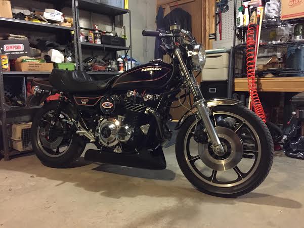

Thanks for the info guys, pm'd Zed1015, will await his reply(middle of the night here) here's one of my buddies rides and my inspiration,
