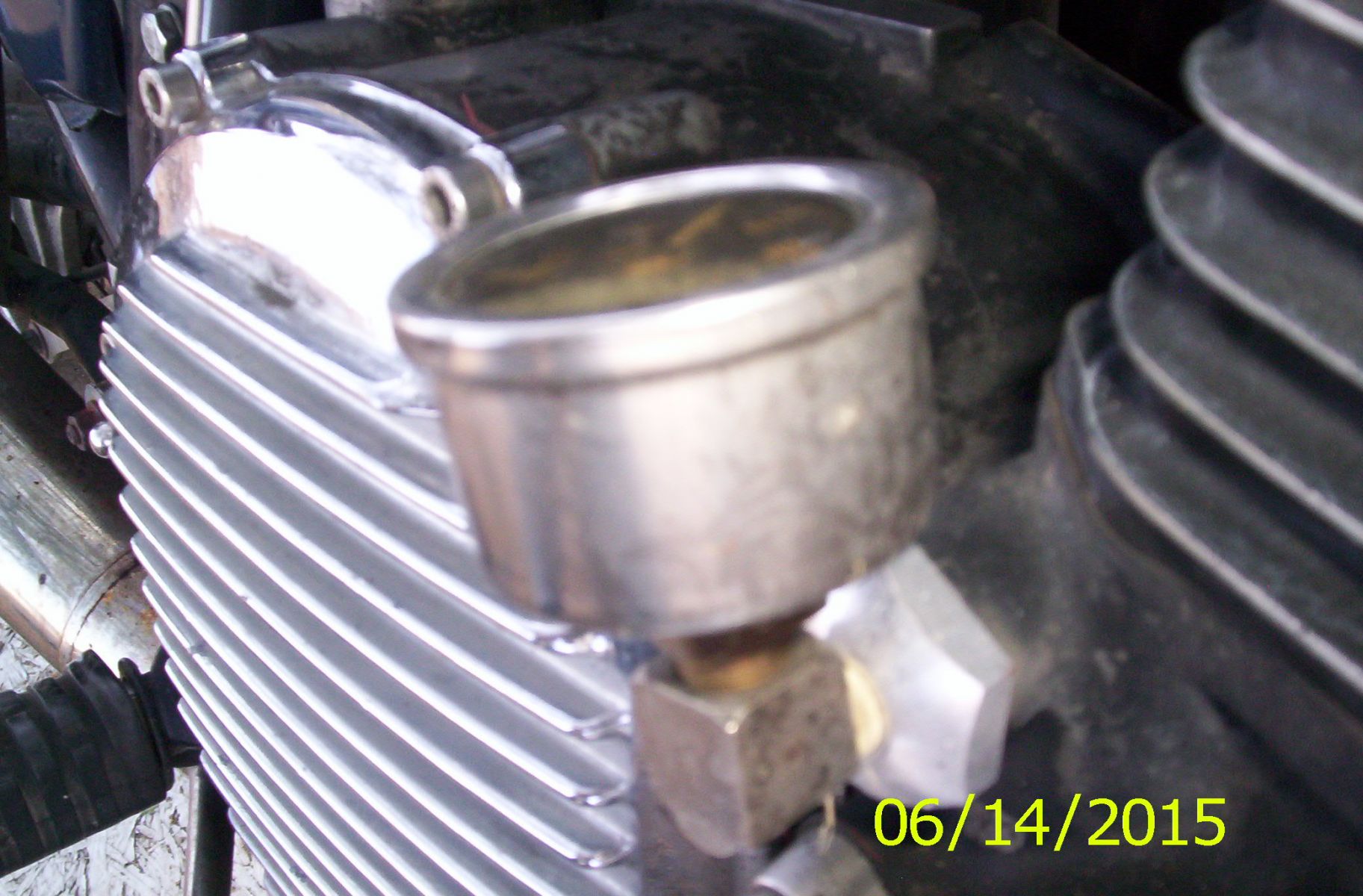

Like to replace the oil pressure gauge that is currently mounted at the oil port on the right side of the motor on my 77' KZ1000A.
Gauge is a 2 1/4" O.D. 80 lb. reading with a 3/8" NPT male end.
Is there a recommended gauge preferably white face with this size male end that would screw into the 90 degree elbow already on the bike?

Lots on eBay. I got a Doremi gauge but blew it out. They sent me another one, it did the same thing. I kept the fittings and got a 60 PSI gauge for a sportster. My oil pressure is very high.

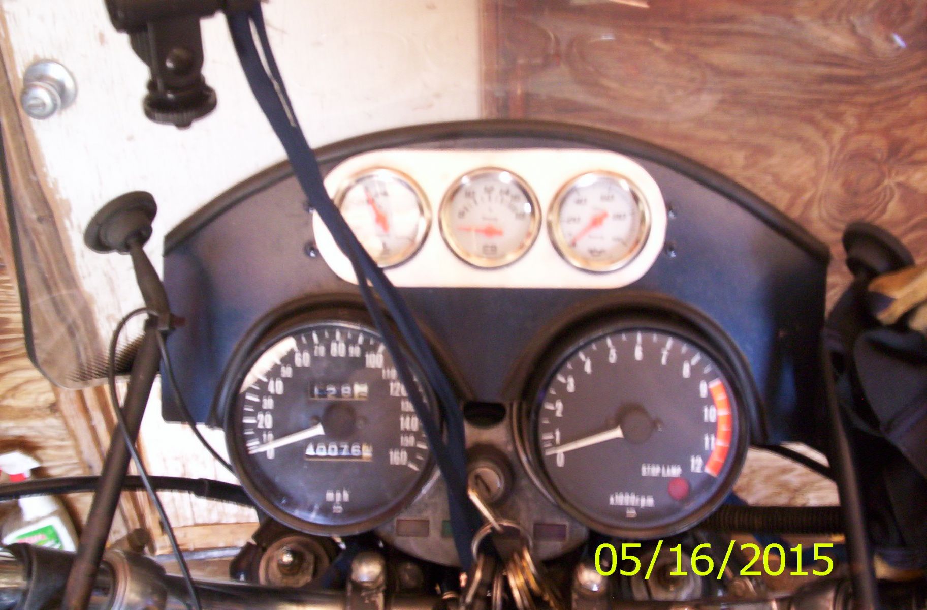

Now that I have the cooler installed. I'm going to put in a tap and hook up the gauge in my dash.

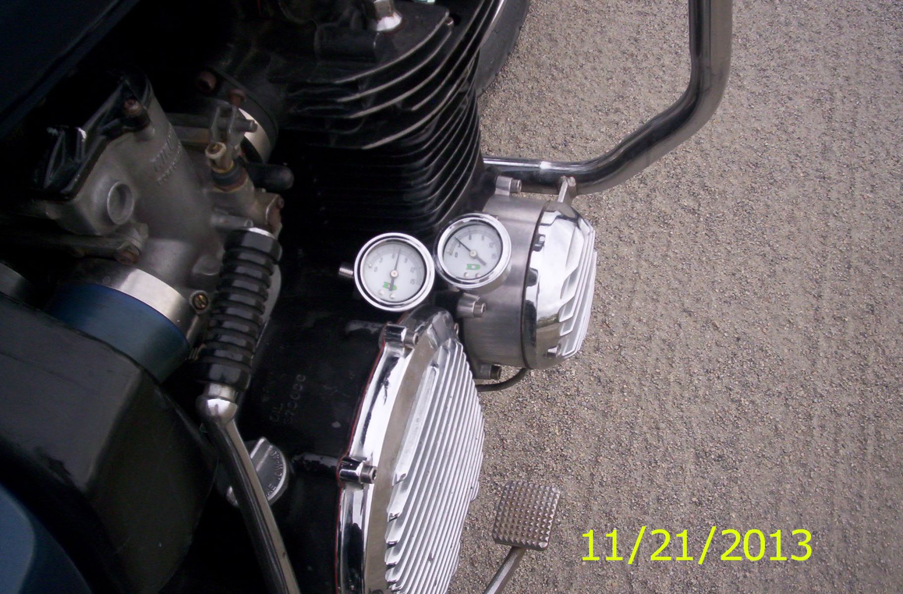

Since Kz 1000s run about 3 psi when hot I have a 15psi gauge on my bike. Its work perfectly since 1980
When motor is cold the gauge reads to 15 or a little more ,
but as the motor comes up to temp the psi drops to a steady 3 or so above idle speed

27 May 2016 18:29
- kzdcw
- 77' KZ1000A
- Posts: 857
- Thanks: 13
Re: Oil Pressure Gauge ???
27 May 2016 18:43
Steve, Identical to your Picture I have on my Bike. I measured Both threaded male ends at both the gauge and at the male threaded in that screws into the motor, it appears they measure 3/8".
My gauge registers 0-80 lbs., so I would like find a gauge like above that registers around 15 lbs.
