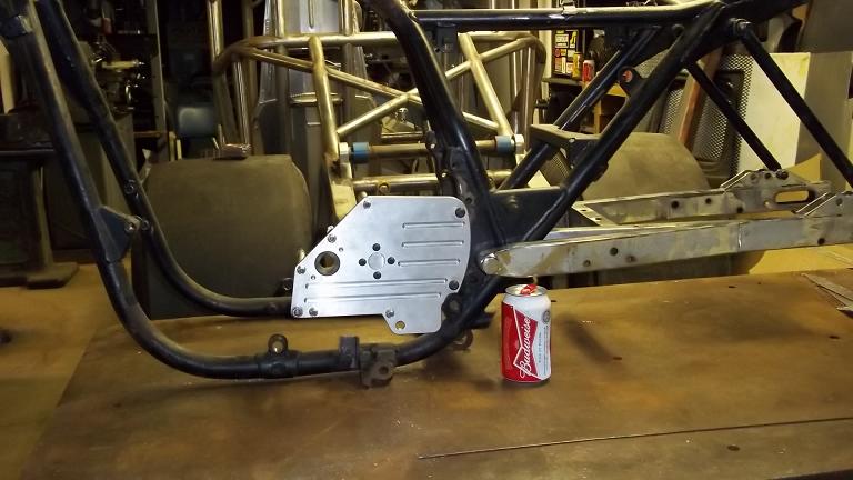

Remember the guy "IrishWill" a machinist from up North. He made up about 10 or so plates. Sold them for a $100.

dang that plate looks good. for the D&G its $265 with the sprocket and bearing. not bad price. the foot pegs, i thought i might i have to move them out about 1/4 to 1/2" but thats what fabrication is about. thanks guys for the imput. Was IrishWill on here as a member?

mocked up. are the weld on bungs a required thing. this will give some support as is. Im not running a slick but this is the first bike ive had to do outboard support. my other bike had a 3/8" and ran a race compound K591 Dunlop 180 tire with a 1385 motor and raced it a few times at drag strip with not a single issue. D&G is quality stuff. Love the look and the fit. my brother has access to a milling machine to make a few little alteraions so i can use the stock footpegs in stock location.

You wouldn't have to weld them though it wouldn't be difficult to do. I was advised by Dave at D&G that if you are running a bike on the street with upto a 5/8" offset, that an outboard support really wasn't required, but doesn't hurt. You do have a lot of rubber back there....lol
