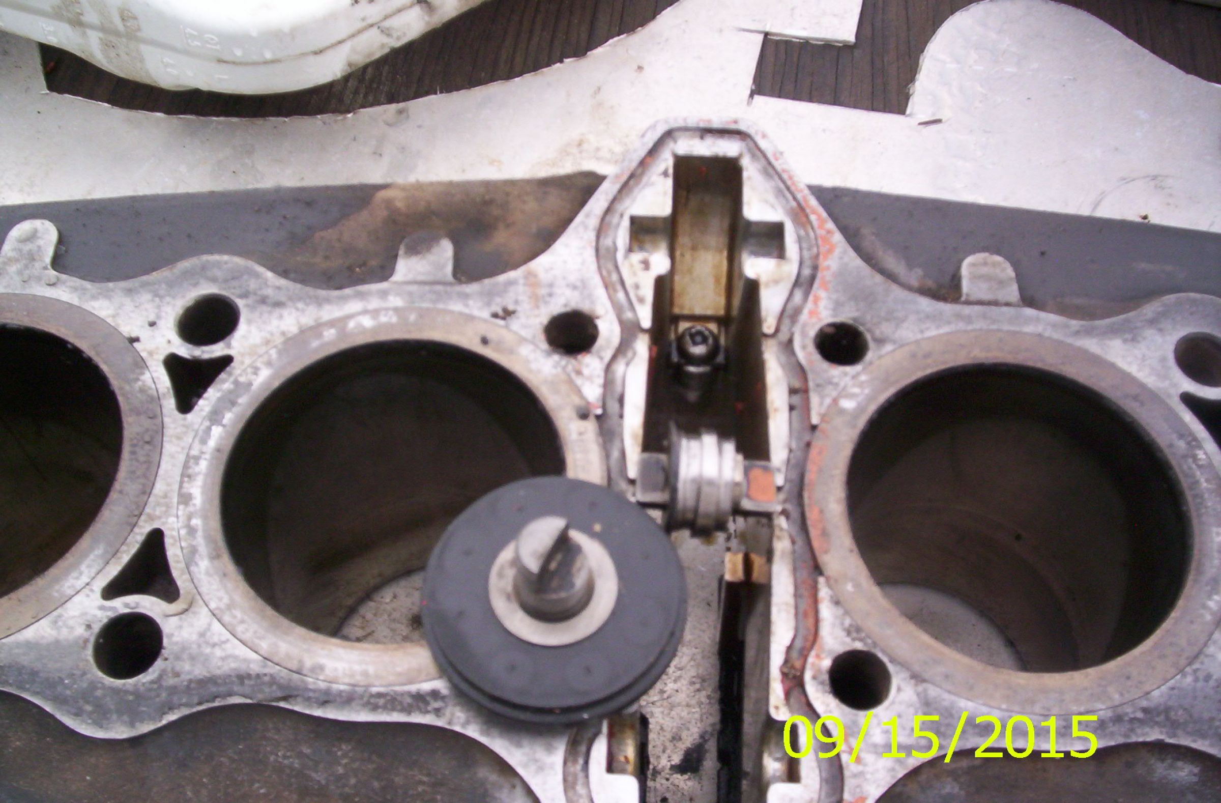

Today I heard very loud click which is most likely sign of bad rollers/chain.
What can I do to diagnose the problem before I remove head?
Should I try to adjust tensioner one more time?

Have you had the valve cover off and looked at the top idler sprocket? All spockets used are the exact same and have endured the same life, so if the visable one is in perfect shape, most likely the others are as well. The other parts like the rubber roller go bad and leave major chunks of rubber in the oil. Have you changed oil and noted major amounts of chunks of unknown origin? If not, I would bet against the sprockets ect. May be your tensioner is bad, The auto tensioner was a major source of problems for many. How many miles on the ST? My KZ1000MKII has 80,000 and not a hint of a problem.

06 Apr 2016 02:04car5car wrote: Today I heard very loud click which is most likely sign of bad rollers/chain.
1.Adjust tensioner
2.
3.,
4,
Thanks.
1. Remove the head.
2. remove the barrels.
3. dismantle the engine.
4. replace cam chain and all associated parts.
5. re-new all gaskets and seals.
6. Rebuild correctly.
No point doing a half arsed job.
If the rollers have got that bad the rest of the motor needs a good looking at.
Most of the cost is in the top end anyway so its only a small cost percentage extra and an little bit more time to sort it once and for all.

06 Apr 2016 04:10car5car wrote: Today I heard very loud click which is most likely sign of bad rollers/chain.
Ive seen more front guides broke off in motors then bad rollers, that will make a lot of slack in the cam chain.

06 Apr 2016 04:55etbike3135 wrote:car5car wrote: Today I heard very loud click which is most likely sign of bad rollers/chain.
Absolutely! but zed1015 gives good advice...
