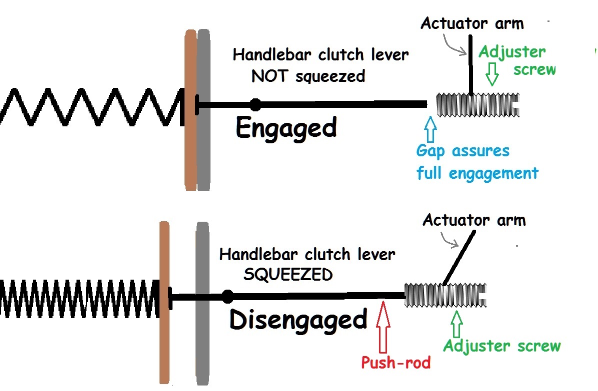

It disengages the clutch when the clutch lever is squeezed. It will get a little oil, hence the need for a seal.

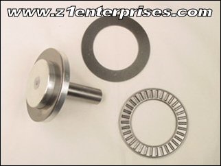

Re: Clutch rod
26 Mar 2016 13:07 - 26 Mar 2016 13:10
Ya know when you beat the snot out of these bikes!
I have had the rod weld itself to the stock ball bearing behind the clutch basket and the OEM parts.
Hence the roller bearing fix they sell for the pusher
