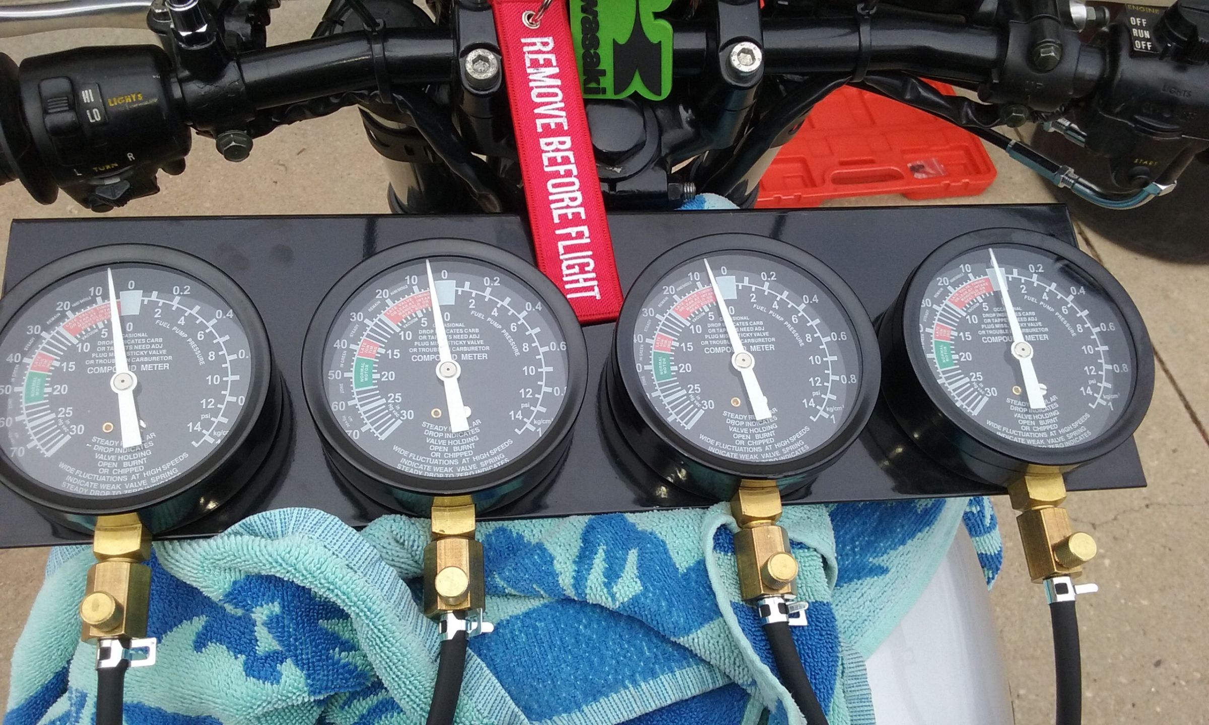

kz650 vacuum reading very low
- blink543
- Posts: 285
- Thanks: 2
Re: kz650 vacuum reading very low
19 Mar 2016 12:34
If you lower the idle they should come up.
- blink543
- Posts: 285
- Thanks: 2
19 Mar 2016 13:25swest wrote: If you lower the idle they should come up.
but it will only stay on with the choke. maybe my slides are closed too far?
Adam james
19 Mar 2016 13:27
Must be something wrong with the pilot system.
- blink543
- Posts: 285
- Thanks: 2
19 Mar 2016 13:29swest wrote: Must be something wrong with the pilot system.
maybe I bench synced wrong?
Adam james
19 Mar 2016 13:32
You bench sync them to make them all the same height. The idle screw should raise or lower the idle. If it won't the pilots are not working.
