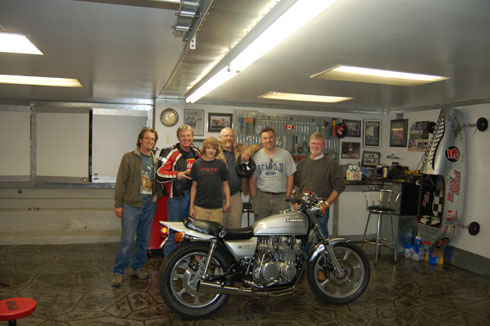

Small kz gang in a garage with the custom 810 that looks like a 650.
Colin / reborn650 (striped jacket) surprised many a bigger bike from time to time.
difficult to see in the pic but he did have carb work done and fitted velocity stacks. I think he may have used gpz 750 cams but not totally sure. Lots of info in the archives
