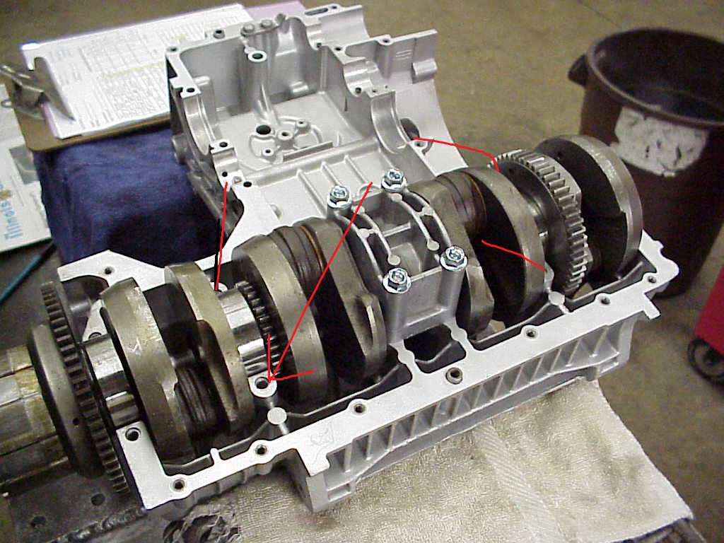

Yes you have to remove the pan, there are case bolts under it. Two under the oil pump and two opposite. There are four in the middle for the crank bearing, those do not have to be removed to split the cases

Correct, remove the pan. Nice pic Greg. No pry screw bosses and oil scavenge plates cast in?

Well crap, that certainly explains why it didn't want to pop apart easily. Got a storm moving in tomorrow, maybe I can find a big pan to flip the engine upside-down onto so the rest of the oil can drain out until I have another chance to work on it. Thanks for the info, this is why I didn't try to force it.

The early engines have three threaded bolt bosses so you can use the crank bolts to pry the cases apart. Trouble is if you don't get all the bolts you could crack the cases. Make sure you get the few bolts on the top and all the bottom ones. The pan has to come off and the oil pump should be removed.

Well I'm getting closer... got the oil pan off tonight and those four internal bolts removed, still not budging though. I don't see anything else on the underside, so if I get a chance tomorrow I'll flip it back over and re-check the top to make sure I didn't miss anything else.
