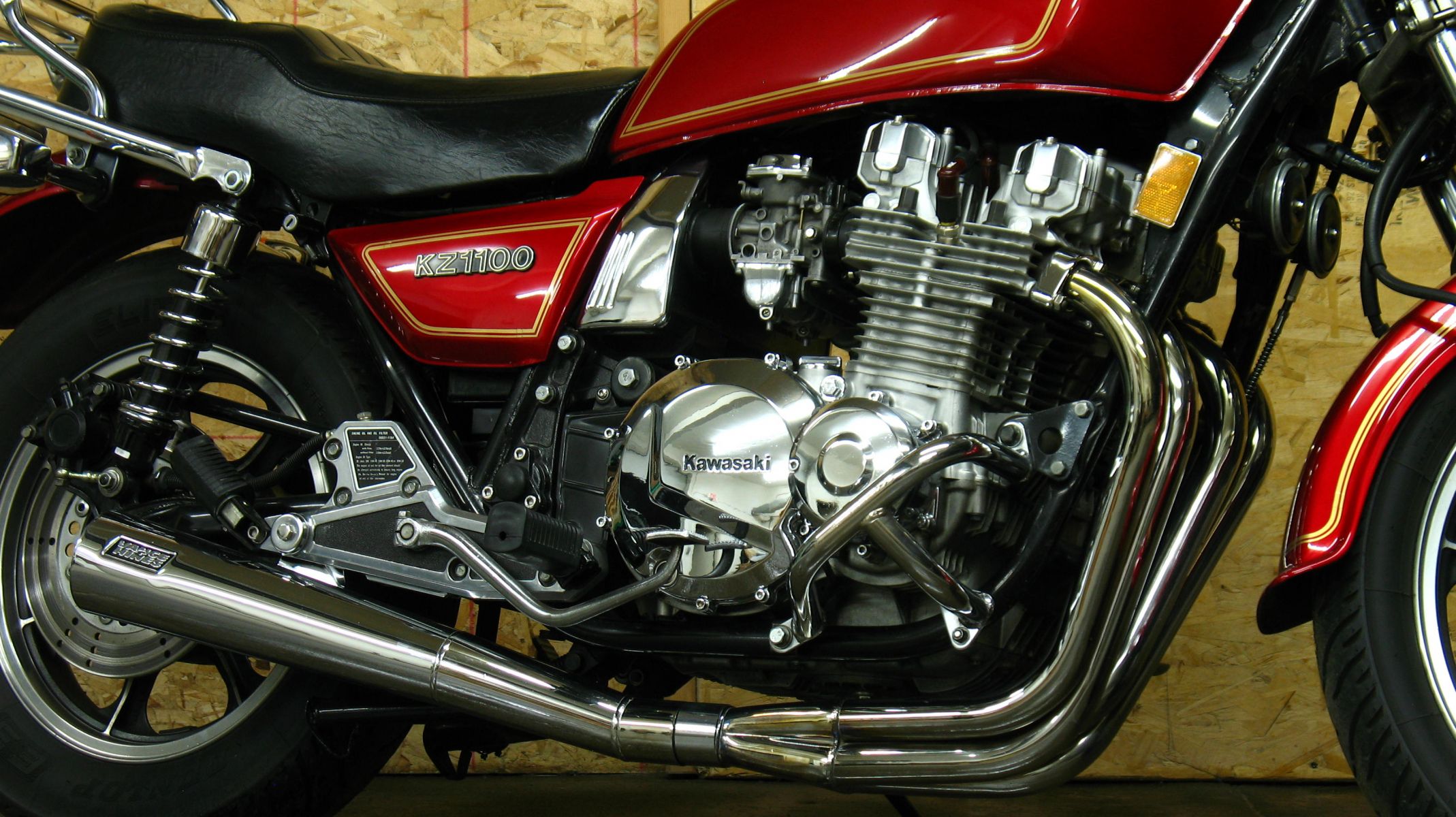

The V&H tech dept. told me that the 13009-J was designed to work only on the KZ1000-J, and not on my KZ1100...period. :huh:
The solution for using that pipe on my bike was a short piece of chromed 2 1/8" O.D. exhaust pipe slip-fit on the collector flange, which serves as a spacer to achieve the necessary length. I flattened out the bracket on the megaphone with a large vise, to effectively tilt the megaphone pipe farther away from the passenger foot peg.
This header setup allows use of the center-stand, and to easily change the oil and filter.
