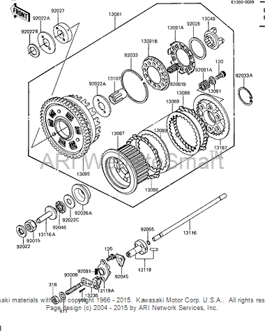

29 Nov 2015 20:28daveo wrote:76KZ900 wrote: The poor condition of the case.. Is a trick of light from having to hold flashlight on area. I can assure you the case where rod goes in is like new.. With oil on it from leak..
My only question is why does seal come out so easy? I'm assuming it should have some sort of press fit and not basically fall out.
It may not matter, but I think you have the seal facing backwards in your photo.
Is there for photo only.. But thanks..

I found the same thing the other day on my 1100 shaft. I got a new seal and its all rubber like the one that was in it. When I put the new seal in I coated the outside edge with a sealer when I put it back.

30 Nov 2015 17:50Im guessing your pushrod is the same as an 84 1100,is it differant on one end from the other?76KZ900 wrote:PLUMMEN wrote: Try pulling the push rod out and reinsert the opposite end into the motor
Can't on a 1100 shaft

As dave pointed out. You have to remove bevel gear to access rod. On mine the rod is internal. Only part that touches seal is rot ating part.
It's not like a chain drive.

30 Nov 2015 19:50eddiem wrote: I found the same thing the other day on my 1100 shaft. I got a new seal and its all rubber like the one that was in it. When I put the new seal in I coated the outside edge with a sealer when I put it back.
Did that fix leak

01 Dec 2015 02:1076KZ900 wrote:eddiem wrote: I found the same thing the other day on my 1100 shaft. I got a new seal and its all rubber like the one that was in it. When I put the new seal in I coated the outside edge with a sealer when I put it back.
Did that fix leak
Make sure to only use the Genuine Kawasaki seal part number 92049-1037

01 Dec 2015 18:0376KZ900 wrote:eddiem wrote: I found the same thing the other day on my 1100 shaft. I got a new seal and its all rubber like the one that was in it. When I put the new seal in I coated the outside edge with a sealer when I put it back.
Did that fix leak
Still workin on it but I don't see why it won't work

Yes it is from kawasaki
daveo wrote:76KZ900 wrote:eddiem wrote: I found the same thing the other day on my 1100 shaft. I got a new seal and its all rubber like the one that was in it. When I put the new seal in I coated the outside edge with a sealer when I put it back.
Did that fix leak
