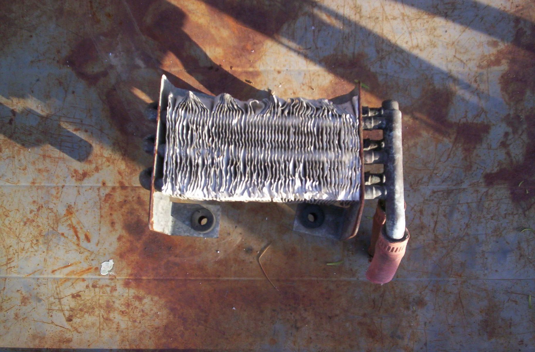

Started playing with it yesterday afternoon. It won't work up side down as I planned. Too big. The top bolt was no problem but the bottom ones I had to make a bracket for. I have some 6.37mm aluminum flat bar stock, so I used that. This stuff is HARD. I;ll have to go flexable lines to criss/cross under it, then behind the steering head, along the back bone tubes, then down between the 2-3 intake boots. 3/8 line all the way. I have a line connecting the inlets to keep out dirt for now. Looking for a 3/8 bypass valve. Should be ready for summer.
Looking at the pics, I need to do some polishing.

Zed 1015's comments were well taken. While watching and commenting on the other cooler thread, I've been quietly playing with mine.
The cooler was meant for a high pressure system. The hoses were 3/8. The fitting size was much smaller.
I cut the nipples off my old cooler, drilled and sweat soldered them to the couplings that came with it. The solder has a high tin content (no lead), so heat shouldn't be a problem. Just in case I flared the inside a little.
Being the lines were small with a O ring, the next step was to open the intakes more. .435"/ 11.08mm. The nipple ID is .434"/ 11.03mm.
There was a lot of meat there. Should work out pretty well.
Now to run the lines. I'll prime the cooler before I put it into service.
More to come.
