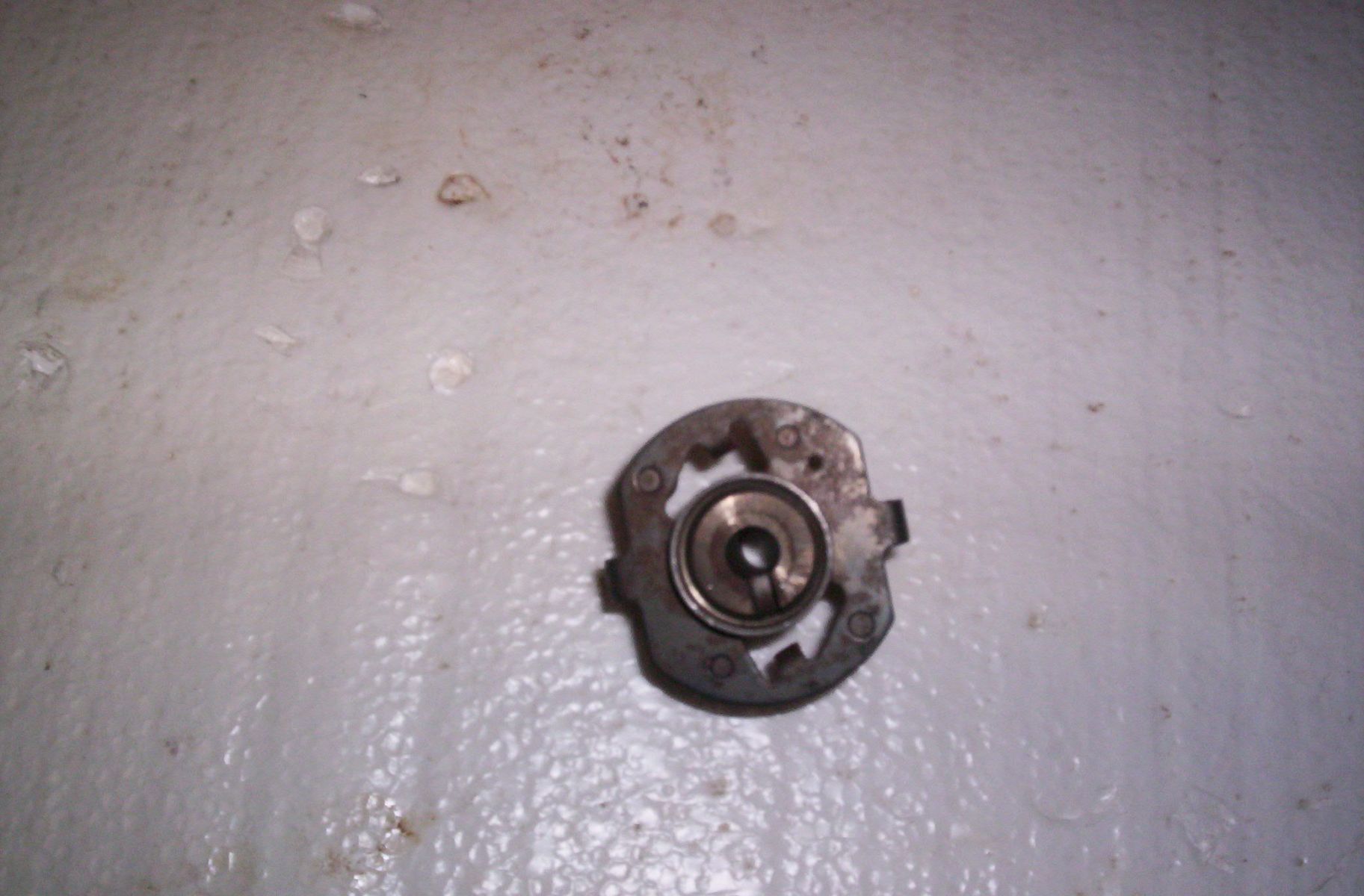

Re: 1981 Kz 550 timing advancer question.
17 Nov 2015 03:16
It'll only be good for parts. I'll take a pic. If you want it, I'll send it for the shipping. I'll need your zip code and PM me with your address if you'd like it.

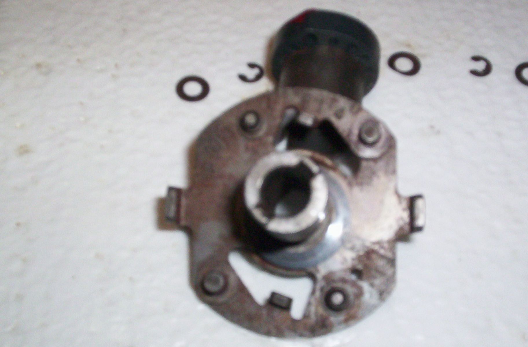

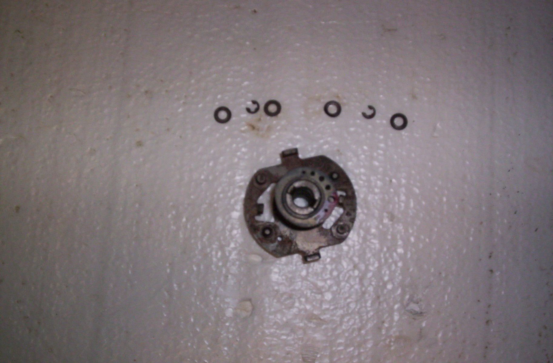

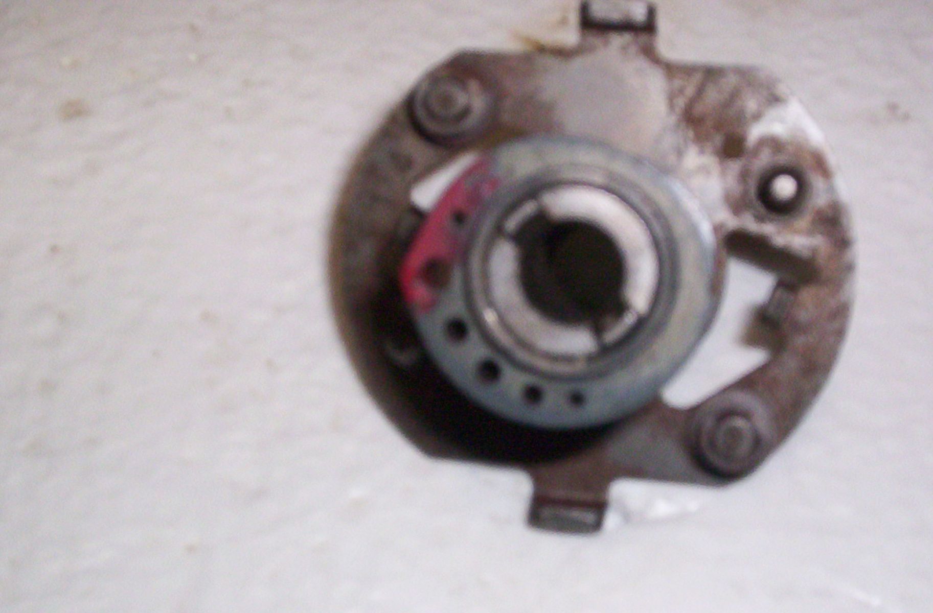

17 Nov 2015 04:05 - 17 Nov 2015 04:06
Got your PM. As long as your arms and springs are good, plus the back/ timing marks are the same, it should work for you. I used the arms on this one because the springs were heavier. I'm keeping my stock arms and springs just in case.
If it will work for you, it's yours and I'll try to get it out today.
17 Nov 2015 04:12
Great that plate is identical. I can swap my parts on. Will be turning the crank again
