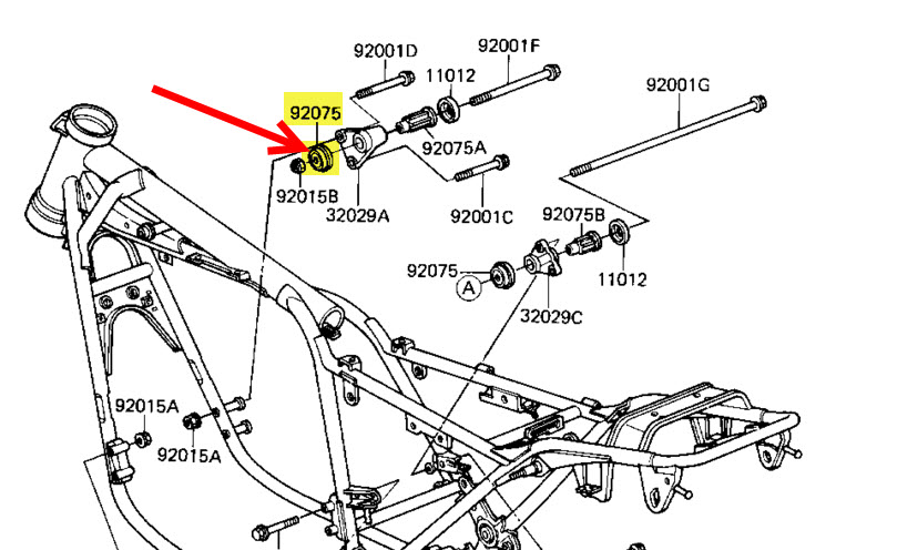

No eBay APP ID and/or Cert ID defined in Kunena configurationTry looking here for some nice parts diagrams...
www.kawasaki.com/Parts/PartsDiagrams/1983/KZ550-M1

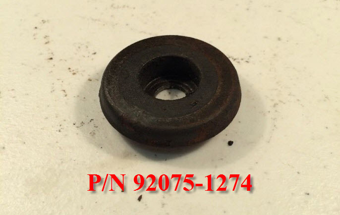

EDIT: I think these spacers are missing (92075)..

You have the later rubber mounted type, you have some spacers missing. You might be able to get some rubber washers and
make up the part if it is unavailable.

I guess I'll look for some spacers in my bolts and screws. Those are the same parts diagram that I have been using and they don't show anything else there either. If anyone has a picture of theirs I would appreciate it. I suppose I couldnt go too wrong if I make something but it's wierd that I don't seem to have anything in my pile. Thanks for the help.

Looks like the 92075 parts are missing.
