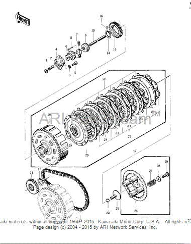

Has the clutch ever functioned properly while in your possession after you acquired the bike from the PO who had disassembled the clutch actuator mechanism?
Perhaps a ball bearing is missing that's supposed to go into the push rod tunnel before the push rod itself is inserted into the tunnel.
Or maybe it's the wrong -- a too short -- push rod or adjuster screw?
Might even be the wrong clutch activator, such as a ball-ramp instead of a screw type, or vice versa.
Am thinking, but not positive, that the bike at hand uses a screw-type clutch actuator mechanism. And which in any event must be the correct part for a 1976 KZ400.
Is the sprocket cover tightened in its normal position when attempting to perform the clutch push rod adjustment?

Well, I figured it out, after probably doing more work than I needed to do. I took apart the clutch end and the actuator end and started fooling around. I verified the clutch basket was assembled properly, bearing was in there, everything was where it was supposed to be. I started trying to do some measurements of when the pushrod was all the way in (seated against the lifter at the clutch end) and it was barely clearing the primary sprocket and chain and for the life of me I couldn't figure out why there was so much distance between the actuator and the pushrod. I ended up cutting the head off an M8x1.25 bolt that was about twice as long as the adjuster screw, and even then it needed screwed in all the way before it would engage the pushrod. After doing this however, I had proper clutch action. At this point, it was getting late so I threw the bike back together and went inside without trying to fire it up.
I was in the shower this morning and was thinking; "how in the hell could there be that much space, it just doesn't make sense!!!" So after getting out I grabbed my phone and looked on ebay for clutch pushrods for KZ400's. Sure enough, mine didn't look like the ones in the pictures. Apparently mine was missing one of the hardened steel "ends" that happened to be about the same distance that I needed to make up, and I was completely unaware as I did not remember it falling off or coming apart when I was going through all the parts. So before I left for work, I went to the garage and searched in my "bucket 'o spare parts" which was basically empty now that the bike was mostly together and I found the missing end of the pushrod.
