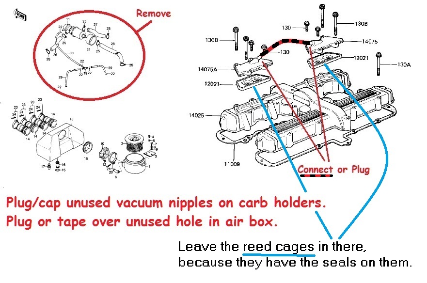

i just fitted the Delkevic exhaust to my 82 750 and am very pleased. The quality is top notch. It's a little loud even with both baffles installed. I'm still using stock jets and the stock air box. It runs great, no signs of a lean condition. I have a wideband O2 gauge I need to hook up to it to see where the air/fuel ratio actually is.
As for eliminating the secondary air system, I just put rubber plugs on each of the bungs on the valve cover and vacuum caps on the carb ports. I'll probably end up removing the bungs and thread aluminum NPT plugs in for a nicer look.

31 Oct 2015 07:41TexasKZ wrote: 1. Buy a Eoro-spec valve cover that never had the system in it and give the whole system a heave ho.
2. Make some sexy aluminum plates to replace the top of each reed case, give the rest a toss. (See APE Raceparts for their version for the 900/1000 engines.)
3. Get a short length of hose to connect the reed boxes together and give the rest to a local landfill.
Instead of spending 50.00 + taxes & shipping for the fancy APE block off plates, I spent about 3.00 dollars for the hose & a couple of clamps
You can't even see it once the tank is on, & spend the 50.00 on some other goodies for your bike

08 May 2019 08:43 - 08 May 2019 08:45JaFlo wrote: i just fitted the Delkevic exhaust to my 82 750 and am very pleased. The quality is top notch. It's a little loud even with both baffles installed. I'm still using stock jets and the stock air box. It runs great, no signs of a lean condition. I have a wideband O2 gauge I need to hook up to it to see where the air/fuel ratio actually is.
What do you mean by "secondary air system?" Are you referring to the tubes at the top of the cylinder head that the vacuum switch connects to? Why would you plug those up? Is that because of the pod filters?
You mention vacuum caps on the carb ports. I only have one that is capped. are you supposed to cap the two that normally connect to the vacuum switch?
I'm wondering if I should have done this a long time ago!!!

All unused vacuum nipples should be capped/plugged. Otherwise, an uncapped vacuum nipple creates a huge intake air leak.
