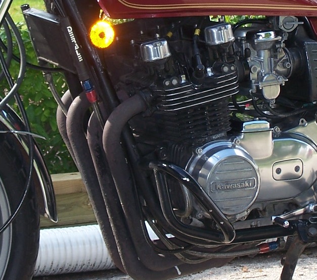

Thats pretty mch what I do when I change the oil. I keep the oil level in the upper half of the oil window. Fill, run, let settle and top up if necessary next day. Dont over fill
I have an after market Derale Oil cooler which was on the bike when I bought it 12 years ago and have had no problems doing it that way.
