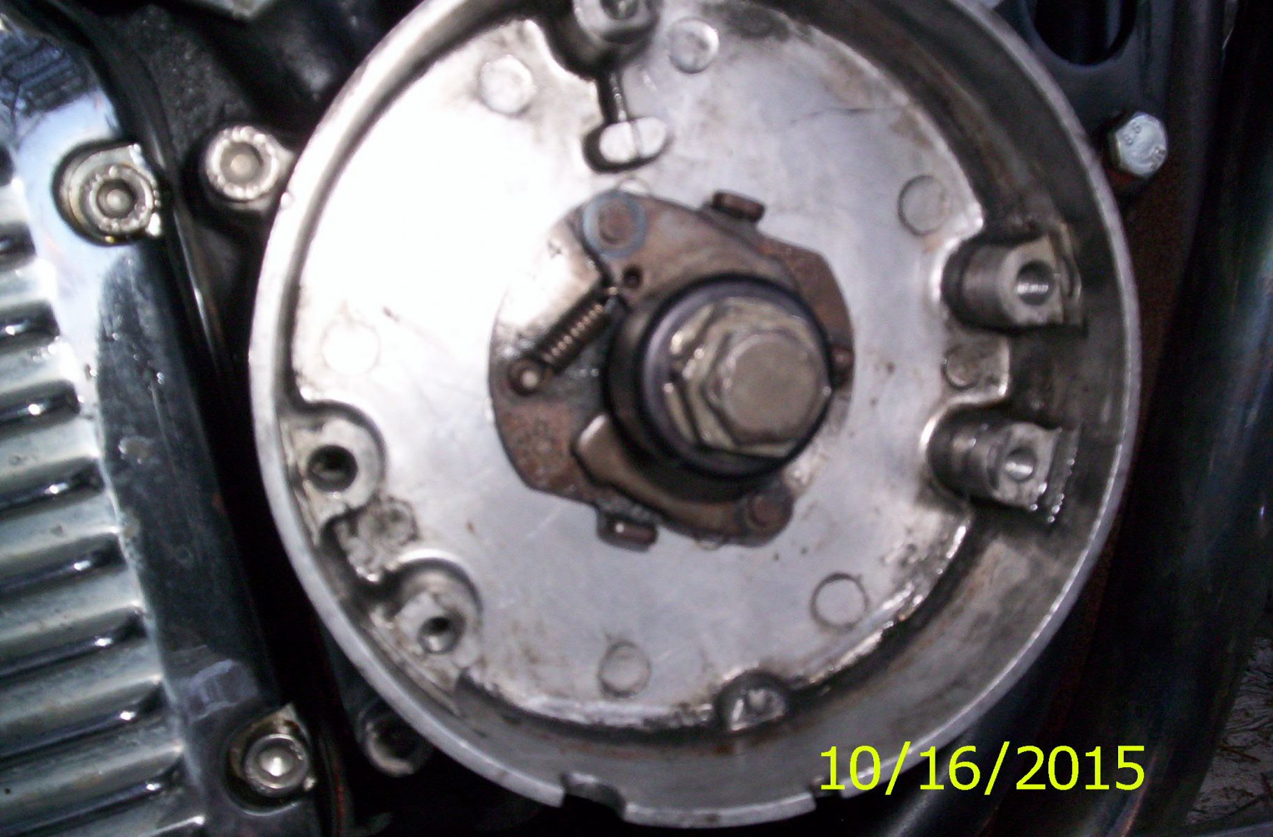

Got my KZ 750 advance. The springs are heavier as are the arms. The T mark is in the same place but the F mark is retarded about about 5*. The full advance mark is in the same place. My springs are very weak so I will switch them and the arms. These springs are heavier as well. We'll see how it goes.

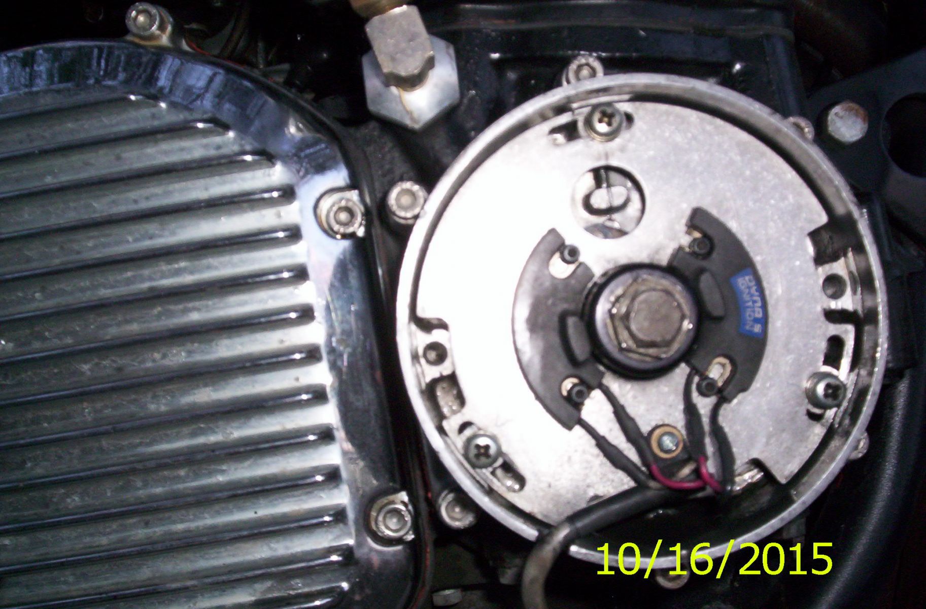

Did the switch. My new Dyna S rotor came today too. I put the advance and rotor on, fired it up. Idle is steadier, the marks don't jump around and it revves faster. Success :woohoo: . If anyone needs the advance plate and rotor just ask. They're in good shape. They're for electronic ignition. The pins on mine are good so I don't need it.

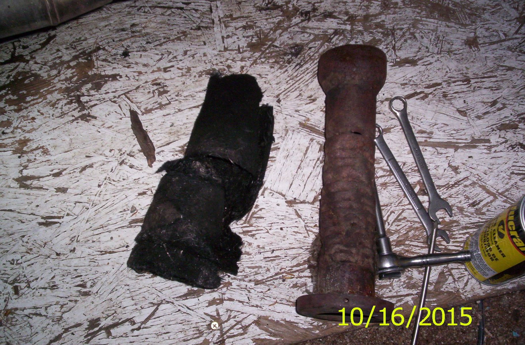

My exhaust was rattling so I took out the baffle and found this. Oil soaked, matted SHT. I took the packing off the drag baffle and put it on the compitition baffle. Much better.

Sounds good Steve. When I was running my Kerker I made my own baffle out of expanded steel and wrapped it with FMF 4-stroke baffling. Sounded great.

Thanks Jon. It was starting to get kinda loud even for me. The rattling is what made me look into it. Glad I did.
