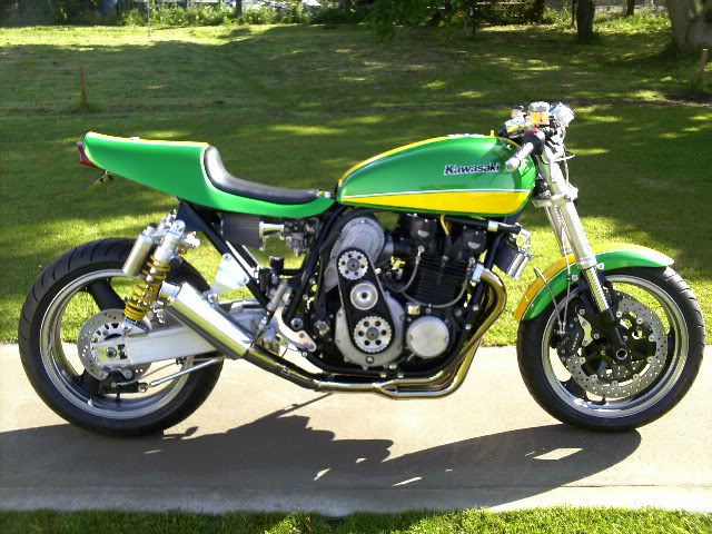

Side routing just looks so daft to me, below and under better but still close to the headers. I might just stick with the original idea with 'over the top' but going further back where the airbox would have been, like pic 1.

Also, a thermostat should be installed so the oil temperature will not be too cold when first warming up the engine or riding on cool days. Too cold and condensation won't evaporate off.
I don't know for sure, but that might be what that silver device is that's spliced into the oil line behind the carbs in the 1st pic. Ed
