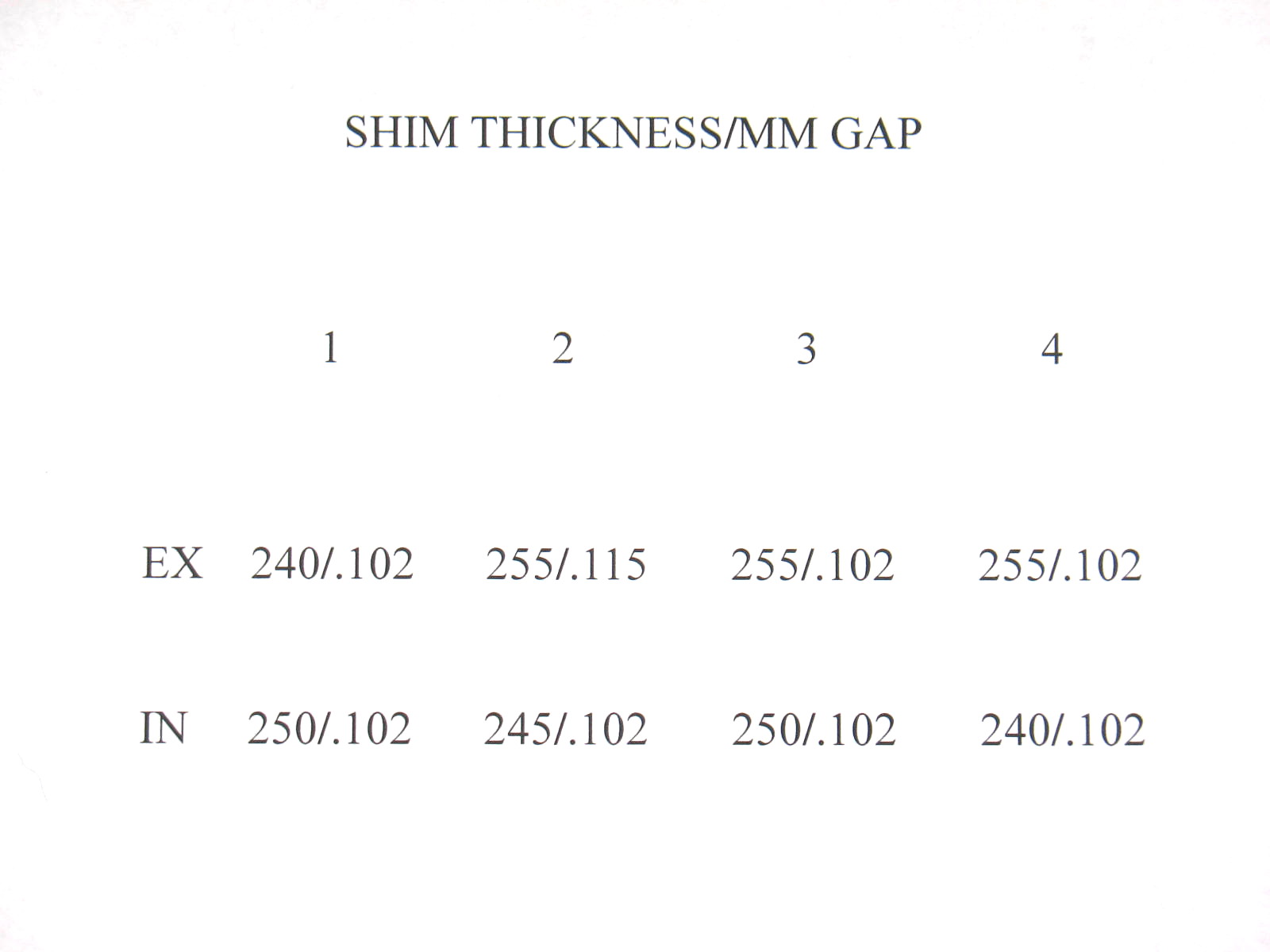

Took the following (averaged) measurements today, 5000 miles since the head/cams were installed on March 19
3 Ex shim was changed from 250 to 255, which was near the upper spec. limit according to the FSM.
All exhausts were within .010+/-mm of measurements shown, while the intakes remained consistent through several repeated checks.
Any comments for me to consider before closing it back up?

Re: Valve Lash Measurements
30 Sep 2015 12:07
Looks fine to me.
1997 KZ1000P (P16)
2001 KZ1000P (P20)
2001 KZ1000P (P20)
30 Sep 2015 12:10
Glad to see this. Maybe the ones that refuse to do their valve adjustments will do them now. :lol: Good job.
30 Sep 2015 12:11
I'd be happy with that, especially when the engine is blazing hot on the middle of the summer on a +90° day!!
