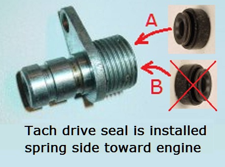

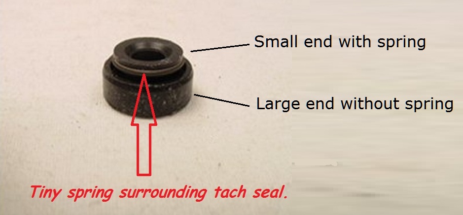

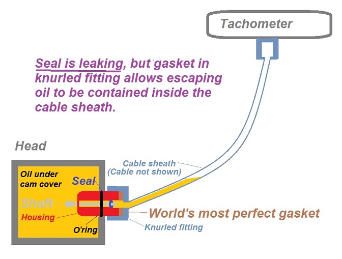

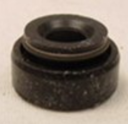

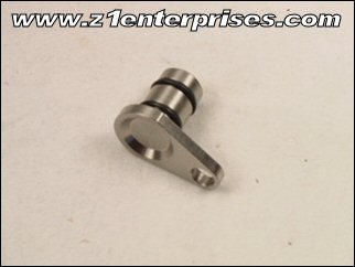

- Posts: 18564
- Thanks: 2103
Re: Tach nut
19 Sep 2015 10:48 - 19 Sep 2015 11:01
The following references are to Z1.
Am uncertain as to extent applicable to KZ750 twin.
Inner seal should prevent any oil from escaping around the shaft. Should remain bone dry with engine running and cable detached.
O'ring prevents oil from escaping around the outside of the housing. Some models have two o'rings on the housing.
PLUG for Z1
INNER SEAL
ANOTHER PLUG EXAMPLE -- Perhaps custom-made??
PLUG for Z1
INNER SEAL
Last edit: 19 Sep 2015 11:01 by Patton.
