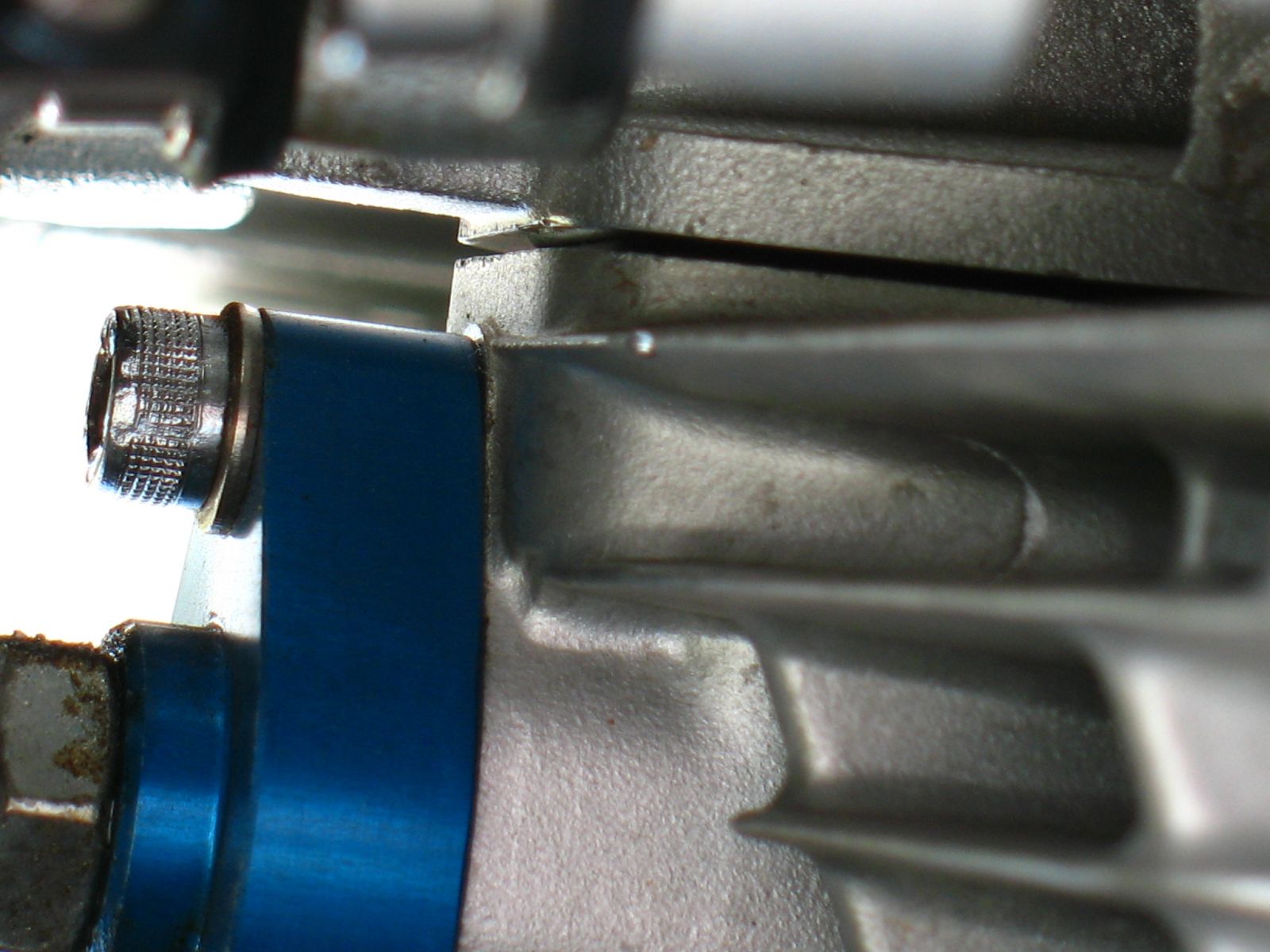

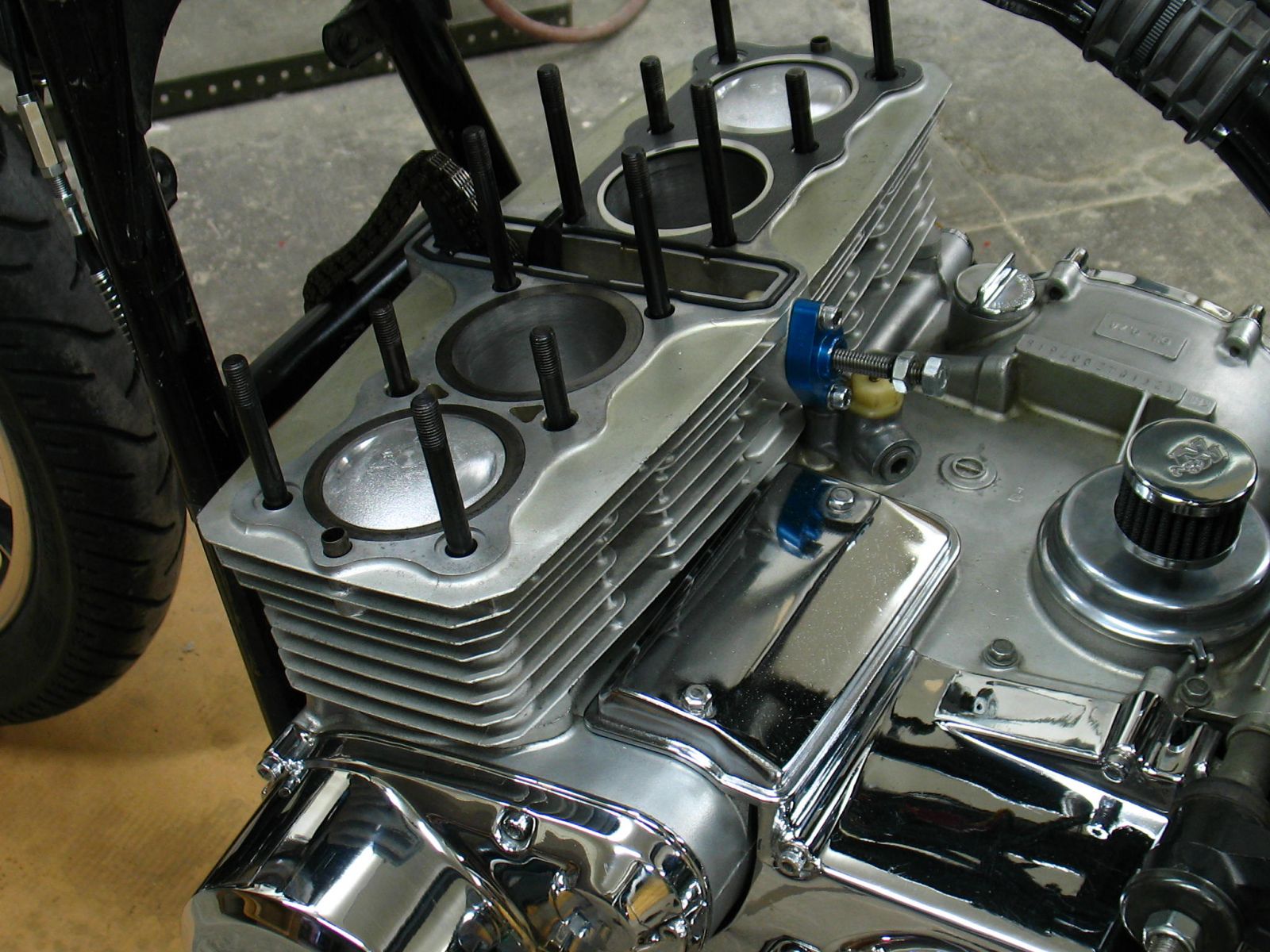

Sorry, but I already wiped the oil off the front and probably won't be able to get a good pic of the back, with the carbs in the way...but here's a reference shot from mid-March when the new top-end was coming together.

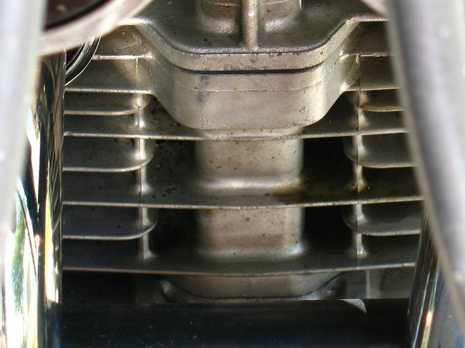

Oil seeps onto the fin below the adjuster, then runs forward due to the angle of the motor when enough has accumulated. It isn't much of a leak, and just shows up at the front occasionally.
I want to have a seal on-hand, before pulling everything to get at it.

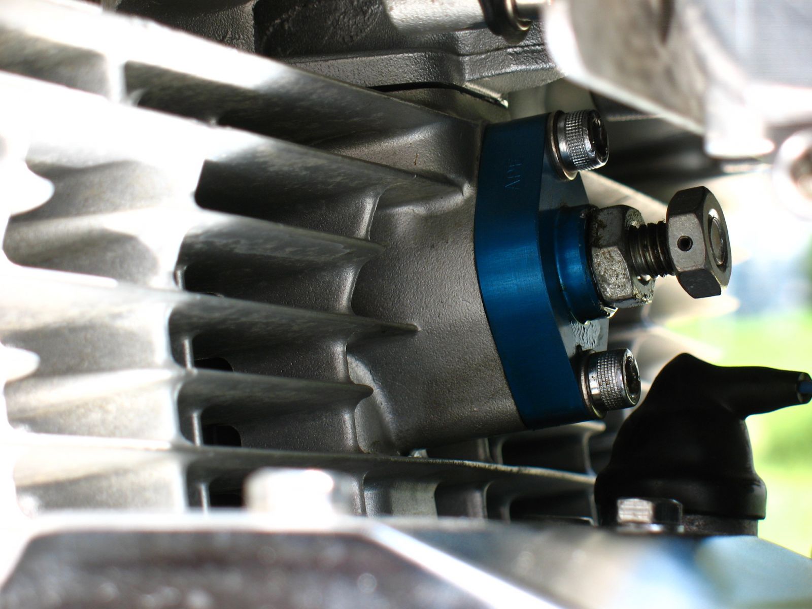

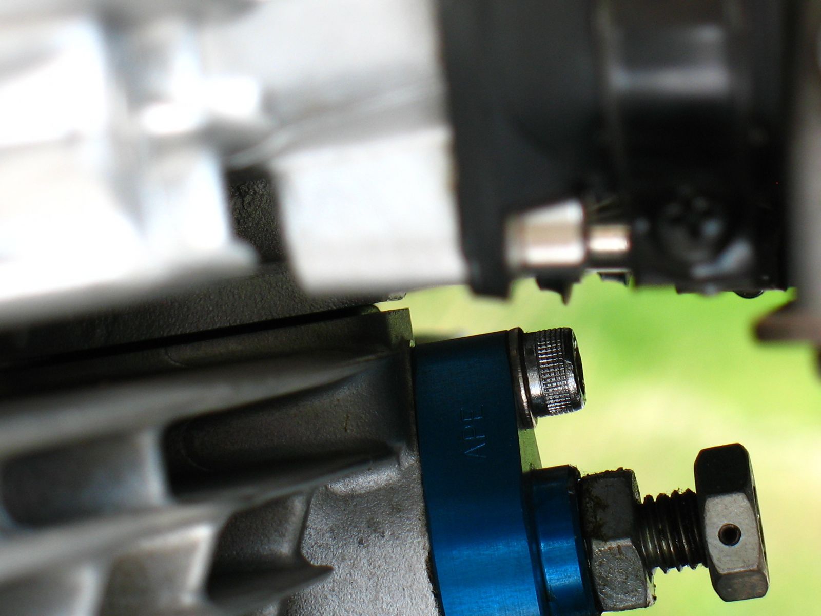

Looking at it closer, it appears the problem is isolated to the small o-ring area on the adjustment shaft behind the jam-nut. That is a tough spot to provide a good seal, since the oil gets past the o-ring by riding along the threads which aren't sealed. Besides, after multiple head swaps, that little o-ring has surely seen it's better days. And with the bike parked most often on the side-stand, that would explain why the oil stayed on the left side, and on the second fin up.
Perhaps if I back the nut off and loosen the bolt enough, I could wipe a coat of Threebond 1211 sealant on the threads before tightening it back up...after a good solvent wash to clean the oil off the adjuster parts. That may do the trick, and save having to remove the unit from the engine, with all that involves...
