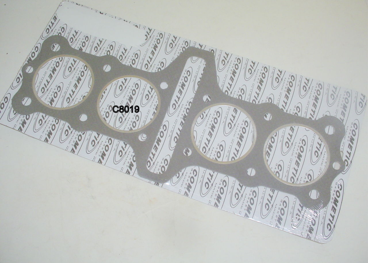

No eBay APP ID and/or Cert ID defined in Kunena configurationI'm done with the two piece head gasket. I found a one piece I'm going to use this time. I used a early Z1 gasket but is smaller than the bore. It worked but this one fits the bores. They have the 70mm, I got the 72.

Yup, I used the 72mm Cometic on my 1075cc rebuild a couple weeks ago too. $50 YIKES! that was painful.
So far... zero leaks.
I did spray it with some light weight, high temp head gasket sealer first, and yes both sides... also filled the O'ring groove with Permatex Ultra Black.

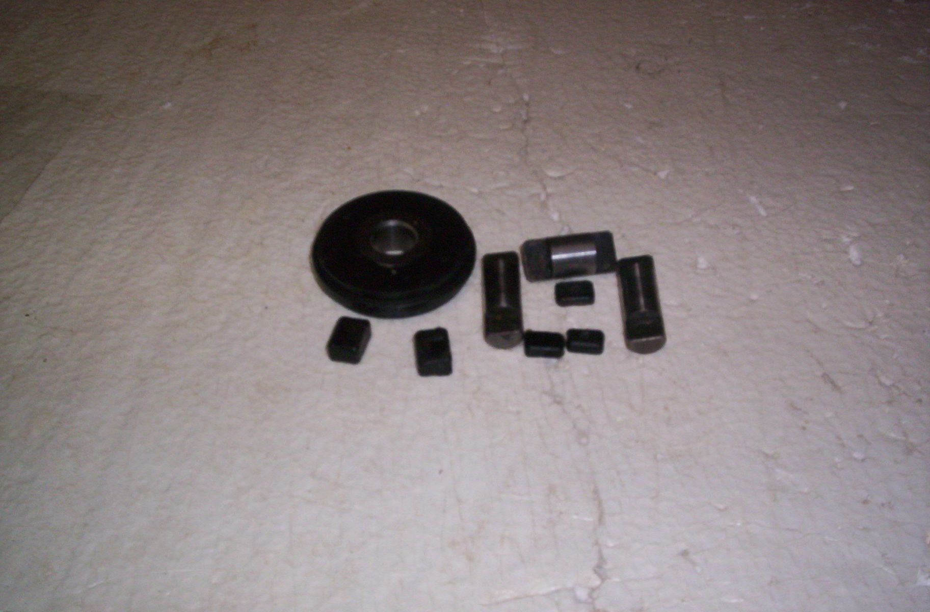

Oh, and I ground down the 4 little damper rubbers for the chain guide shafts....to about .170" so they weren't too proud over the block.

The gasket shouldn't need sealer. I do use High Temp copper silicon to fill the groove for the O ring. I don't let it dry and cut it. I put in enough so it will squish out and smear some around the top along the cam chain shaft. If I were to use a copper head gasket, I'd spray both sides with copper coat and use the RTV on the O ring groove. The rubber cushions need to be there untouched. Otherwise the shafts can move around. If they're hard, the need to be replaced. I picked up these things last year used on eBay in good shape. One roller shaft was a little worn last time I was in there and have been planning to do the pistons and change them while I'm at it. :whistle:
Unless you have deep pockets, (I don't) these things need to be gathered piece by piece. :dry:

I've tried squeezing silicon in there, didn't work. Tried JB Weld, no good. The only way to get it to stop is a new one or a one piece gasket. The aftermarket O rings just don't last. Mine in 13 was new, I was talked out of a one piece copper one, Z1E doesn't carry the one piece fiber, so I regretted it for a year with oil all over my foot.
I used a 900 fiber gasket just to see if it would work. No leaks. This time it's going to be a one piece fiber gasket for the 1015. $50 is what they charge for the two piece and the lousy O ring is extra. F THAT.

I'm trying to see who has a one piece cometic head gasket for a stock KZ900 now.
