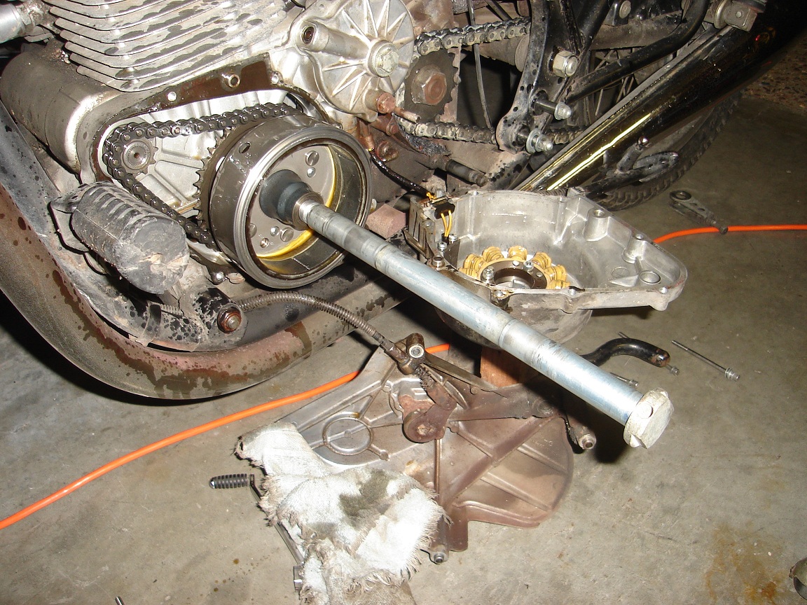

It's a long shot, but check the generator. There have been instances on some KZ's where something comes loose inside that cover and jams preventing the crankshaft from rotating. Ed

Are these two seperate problems? I dont see an electrical problem seizing the engine. I would try and get the engine turning over by hand/foot first to make sure that its not seized . If you had problems with the starter already,I would pull it out and try and turn the engine over.(Plugs out ).
If not, as 650ed suggested,check the genny hasnt disintegrated and locked up the crank.

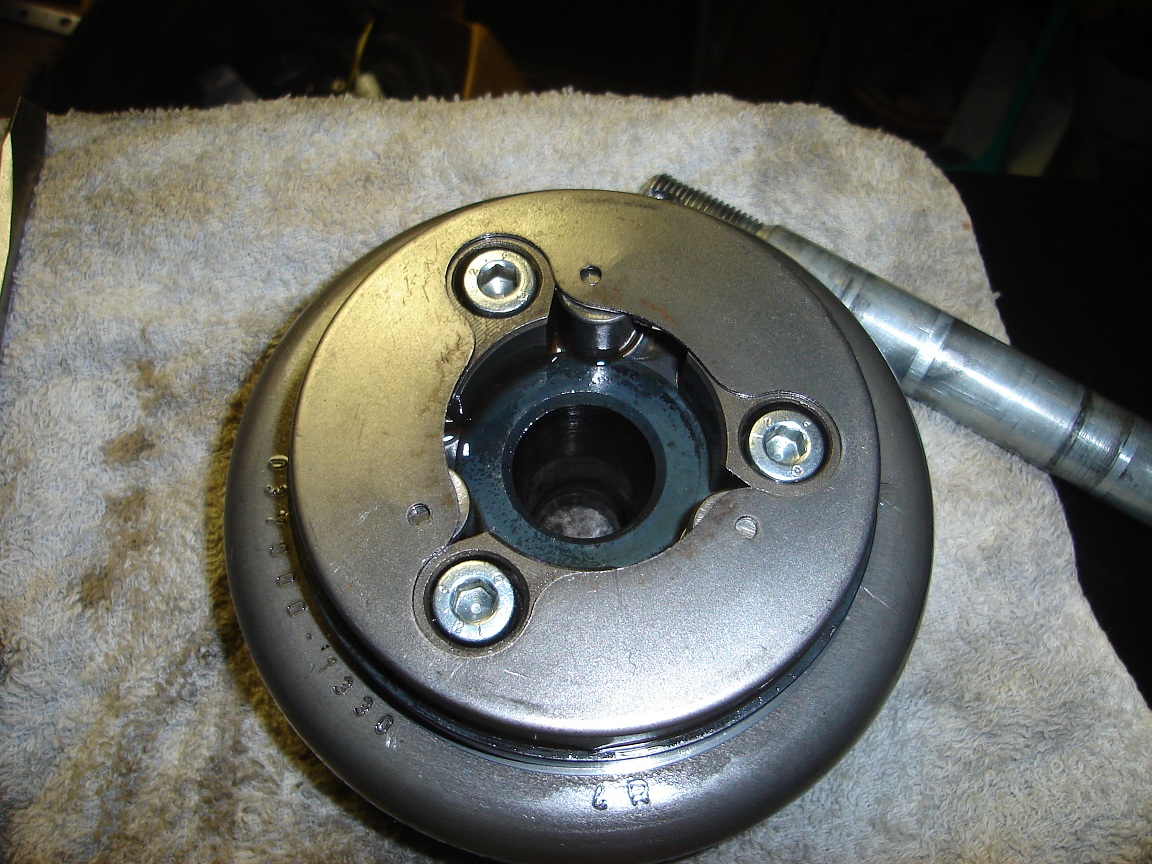

Check the starter clutch mounting bolts on the back side of the fly wheel. If they come loose they can cause the lockup you have.
To remove the fly wheel, the 22mm threads on the rear axle fit the fly wheel threads. These are right hand threads.
The flywheel retainer bolt is left hand thread. When re-installing, thread locking compound is recommended.
Bike should be on center stand before removing the stator side cover as this area is open to the crank case and will leak out oil if on the side stand.
Good luck,
Jim
Good luck,
Jim

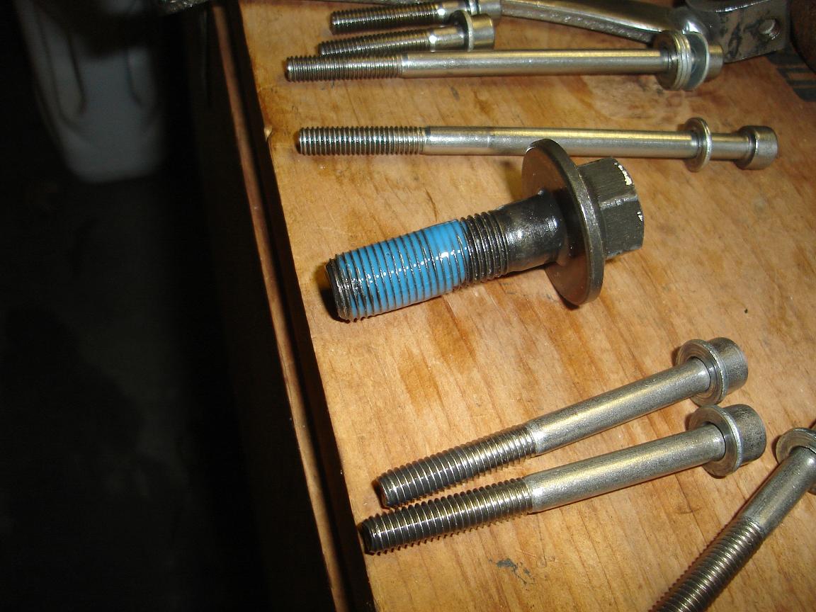

- toyotakzrider
- Posts: 50
- Thanks: 2
Re: BAD BAD BAD.......
29 Aug 2015 12:39
That was exactly the problem. I've had an ongoing issue with those damn bolts backing out. very very aggrivating.... Last time they backed out a little bit and then sheered off. So I replaced them and put blue locktite on them. Well aparently that didn't work either. As they were all loose again this time, one had backed out and locked up the motor. I'm glad I wasn't at speed when it happened. Anyway, took it apart. AGAIN bought new bolts as the heads were all messed up from making contact with everything else. and put them back together AGAIN, this time, with RED locktite. It better hold this time, I'm tired of tearing it apart every month to fix it again.
thanks for all everyones help once again.
