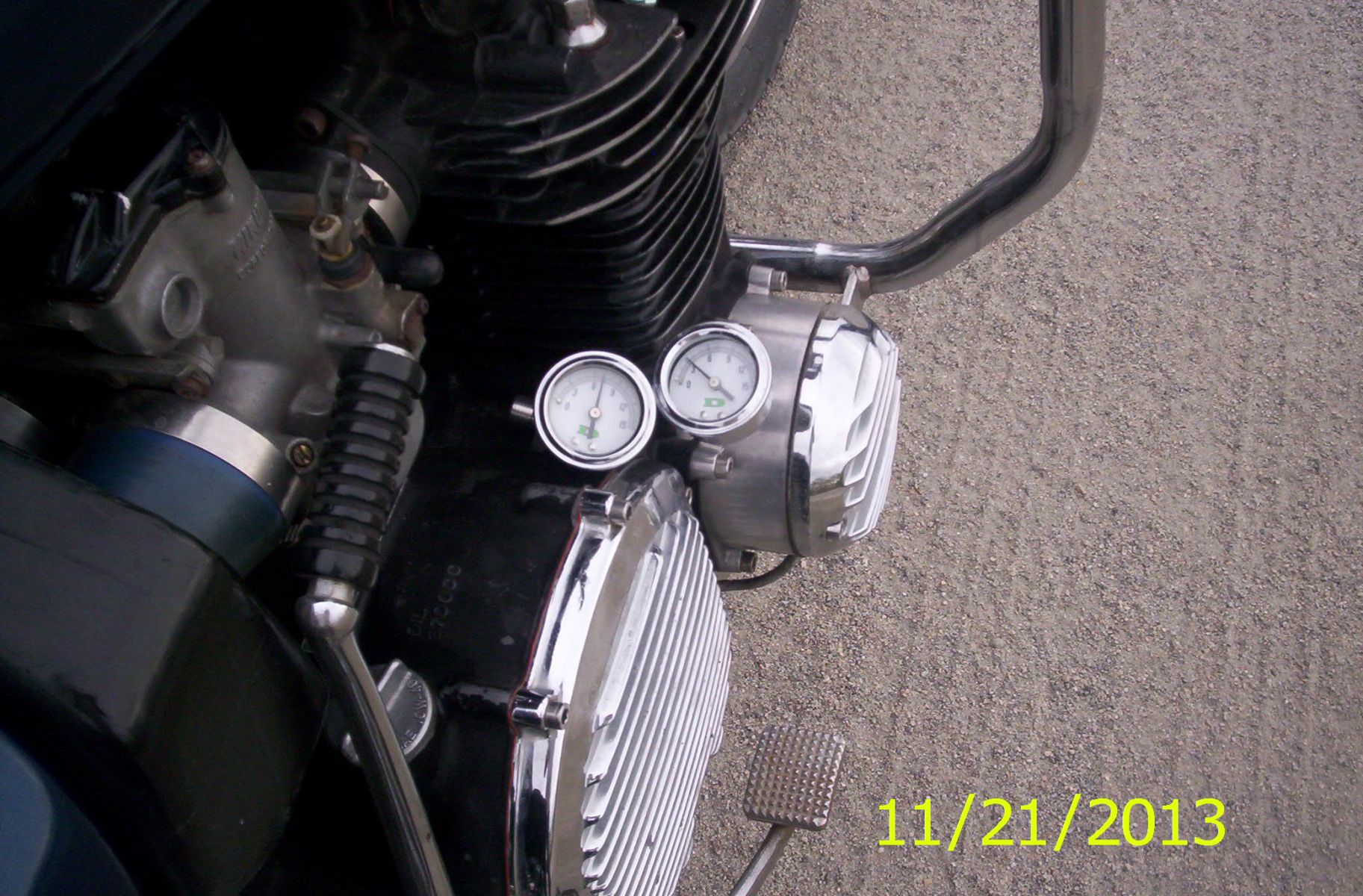

I bought two Doremi oil pressure gauges. Blew both. I now run a Sportster gauge that goes up to 60 PSI. I reworked my oil pump and on cold start up it can go up to 30 on high rev.
