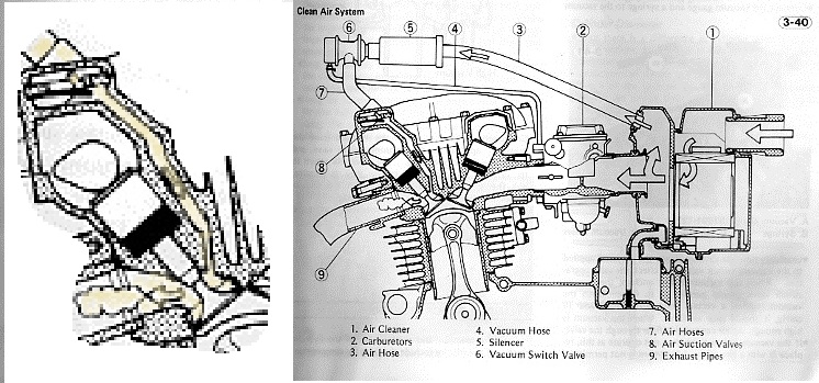

The clean air paraphernalia isn't needed and may be removed to rule it out as the possible source of air leakage.

I've been debating removing that for a long time but never did because I have no idea what it does. I did find some cracks on the ends of the hoses for the smog system so I think I will remove it now. Does anyone know the hose sizes and the types of plugs I will need to link the two reed covers together ?
