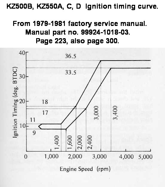

EDIT: So the next step is to confirm timing with a strobe. You just need to confirm the advancer starts to advance (moves off the F line mark) at about 1500 and doesn't get to fully advanced (two line mark) before 3000.
For reference, here is the desired curve.
