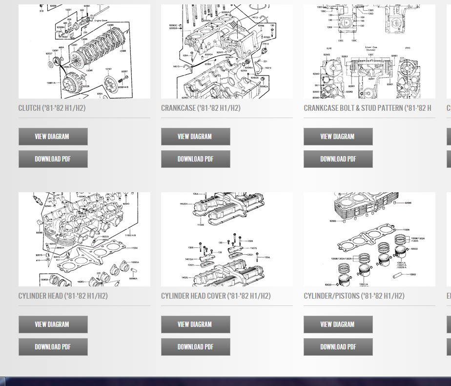

Ok. Engine block is here. Everything looks pretty good. The paint is in poor shape but I plan on removing it anyhow. I am a little confused. I thought when it came off a kz750 it said 749 on the block....mine says 819 also the Pistons say 819..... the Pistons were not marked for the cylinder they came out of. The rings look pretty good to me. What do you guys think?

Looks like a NOS piston shows the same.
