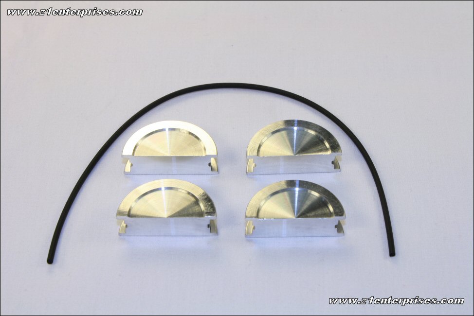

I've got new aluminum cam end plugs and they won't fit the right side of my cylinder head ('78 KZ1000 A). I measured the casting thickness of the head at the cam plug area:
LH side = .0245"
RH side = .0275"
Aluminum cam end plugs are .0265" inside width (lip on both sides)
The cylinder head casting must be slightly off center. The original rubber plugs fit fine since there is a lip on only one side.
So now I'm wondering if any specific brand of aluminum plug ends would be wide enough for this head? Anybody had this problem before? It's a new one for me....
These are the plugs I bought and they are all exactly the same size:
LH side = .0245"
RH side = .0275"

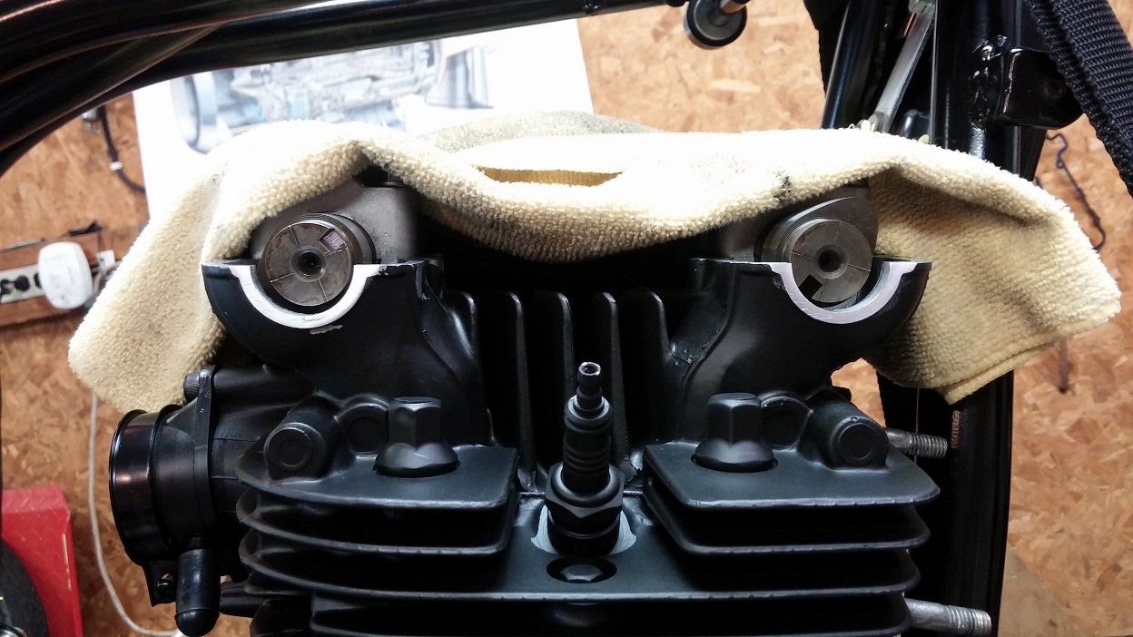

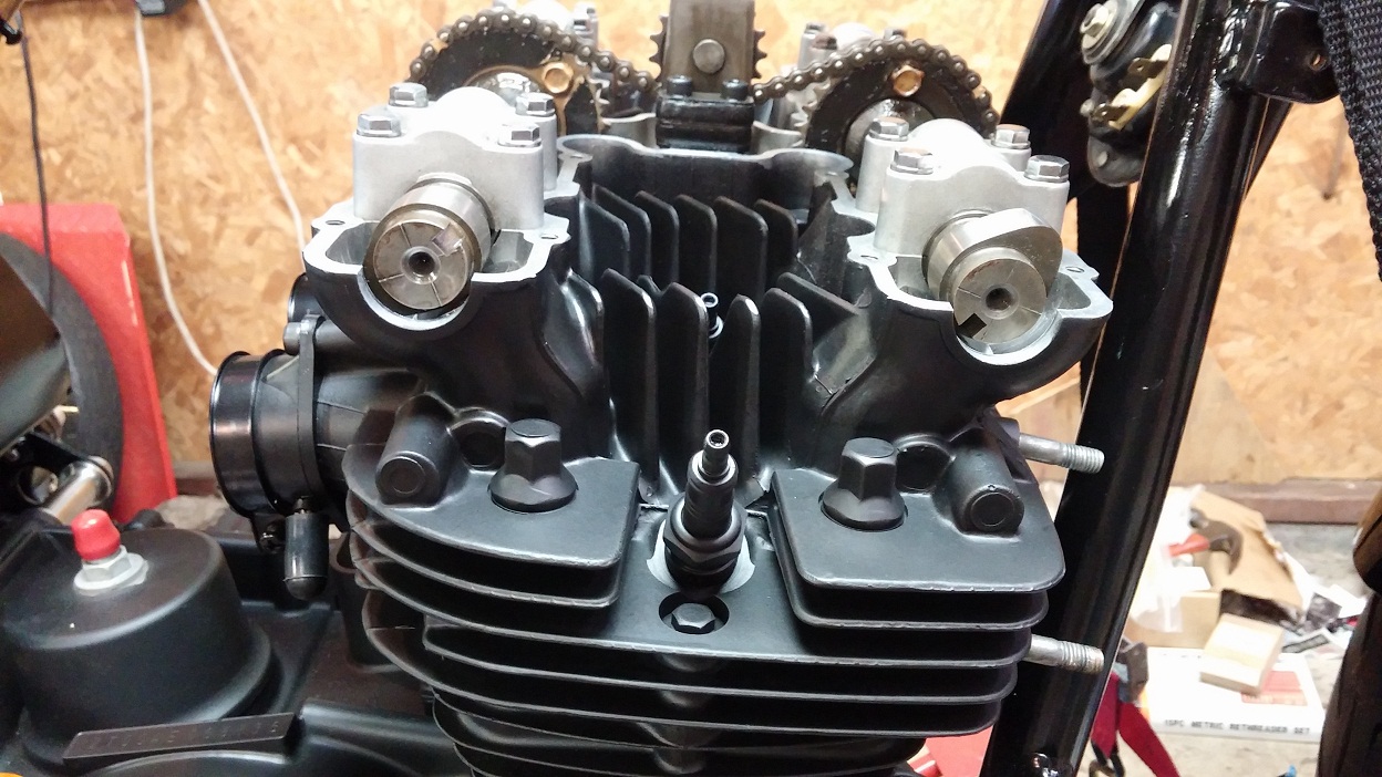

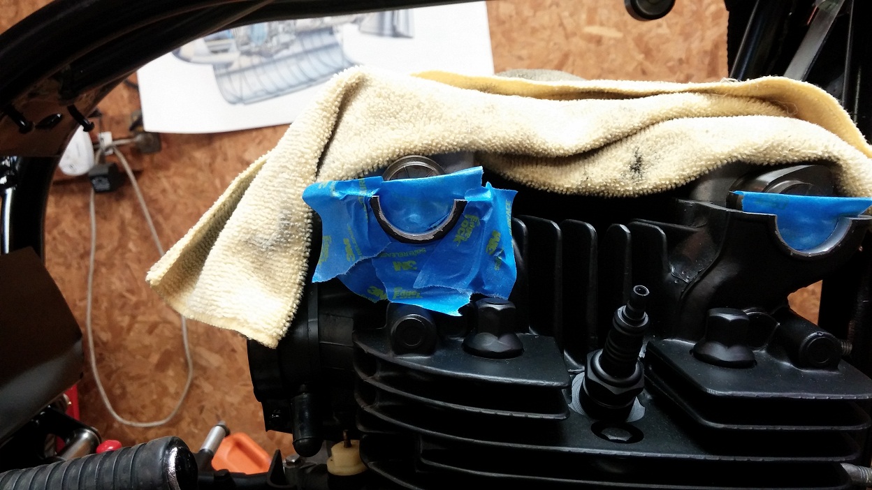

21 Jul 2015 12:52 - 21 Jul 2015 13:01peter1958 wrote: Cant you just file a little off the casting on the right side?
I didn't realize the area around the cam end plugs was raised so much. That made it very easy to neatly file down that area to the proper size. All fixed....thanks!
Prep before filing:
Filed:
Filed, sanded, touched up - Finished:
