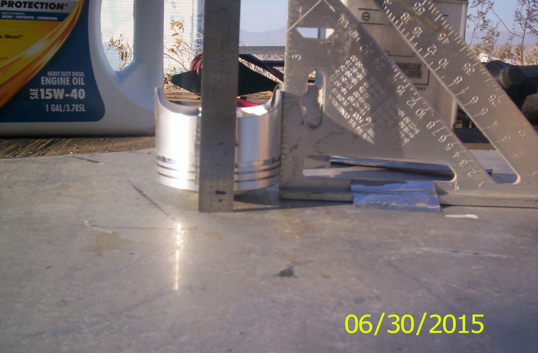

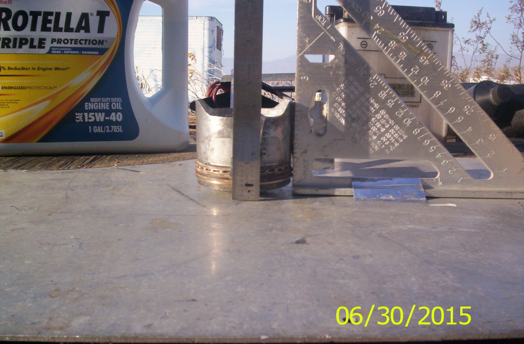

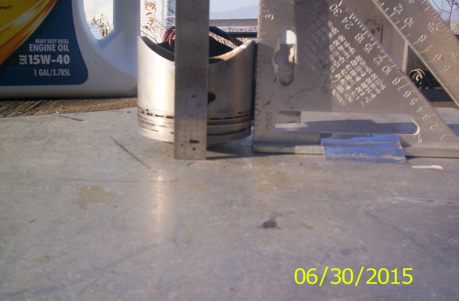

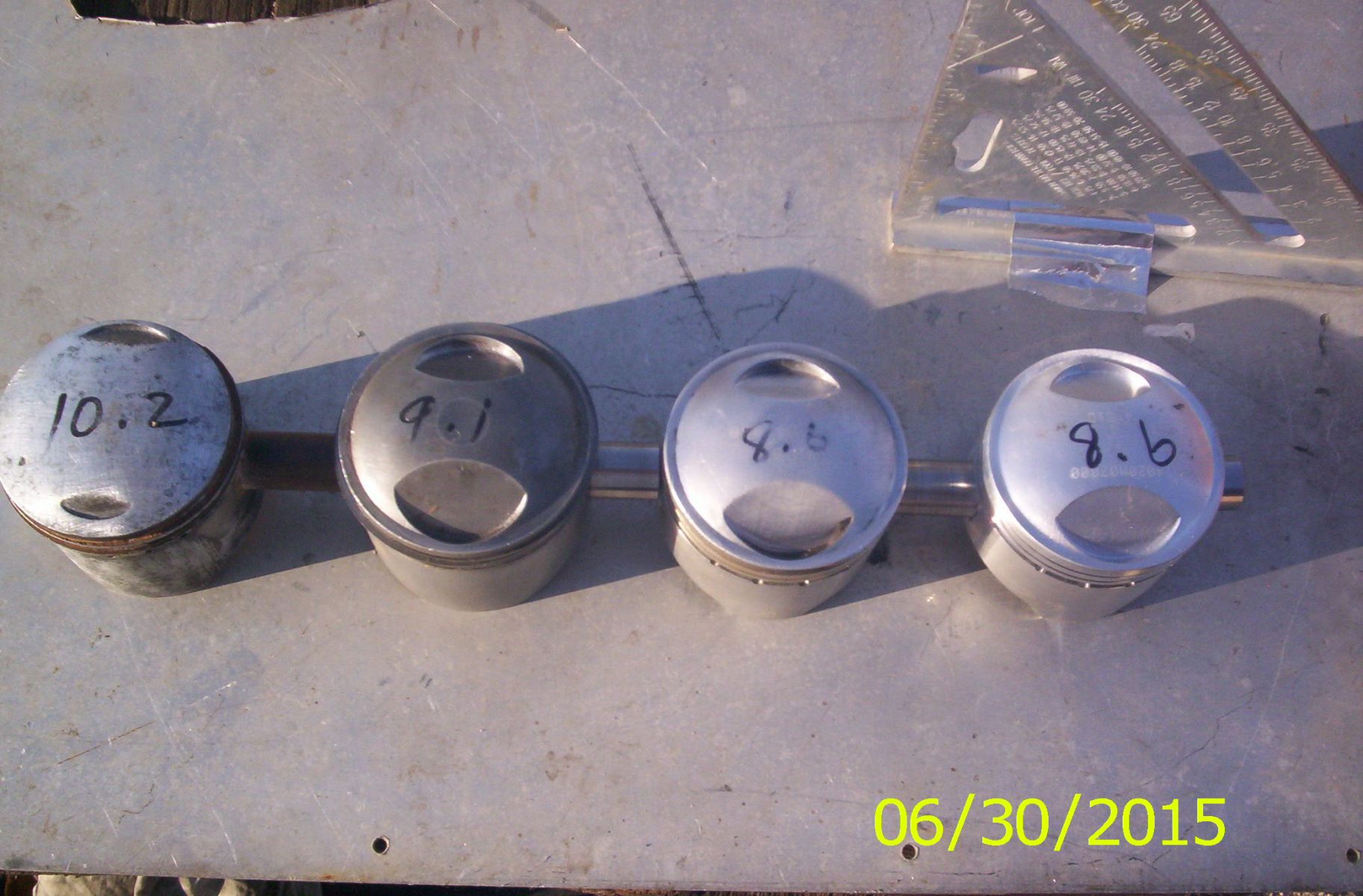

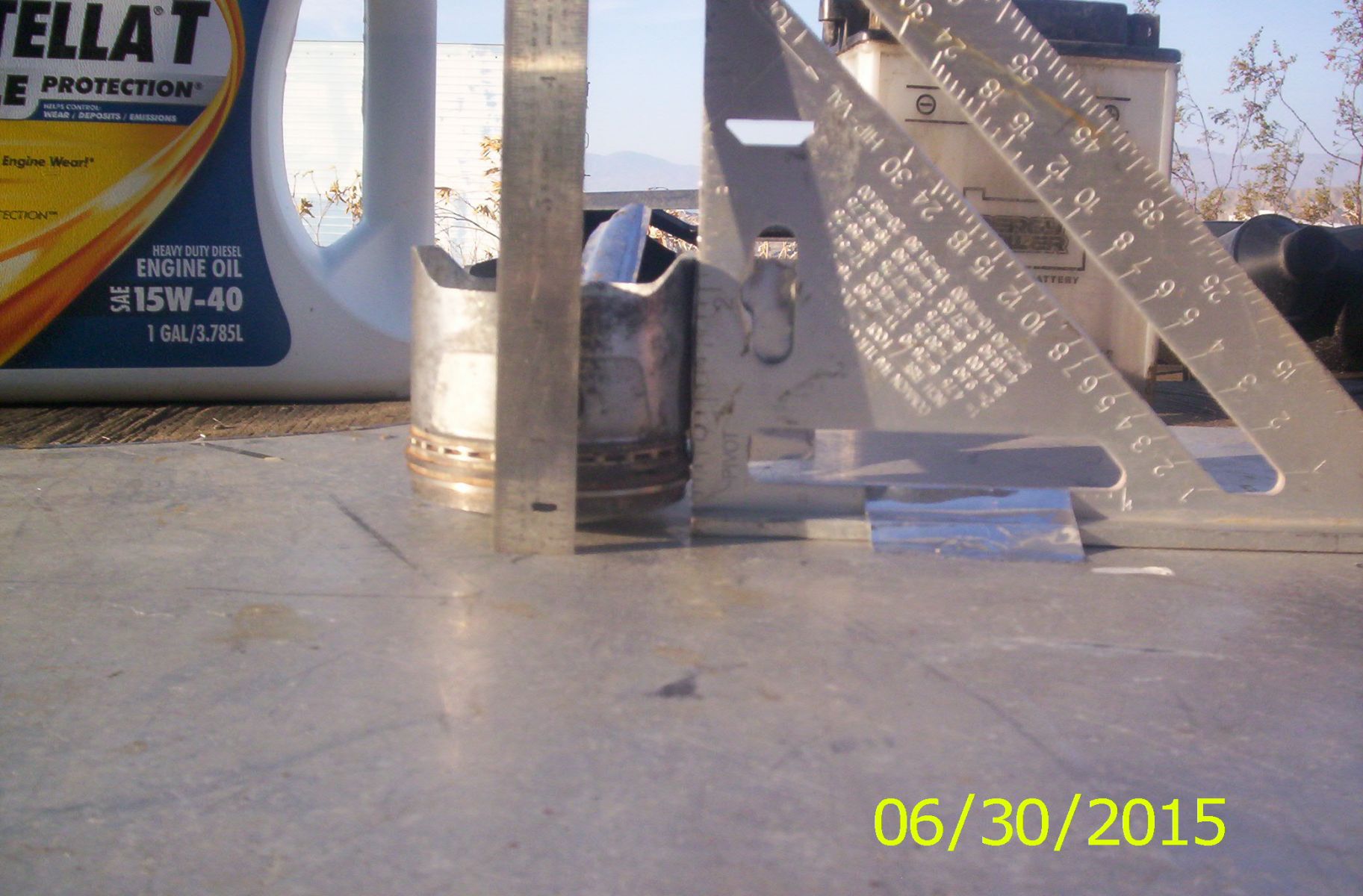

Got some rough measurements. My rule is in inches not millimeters so I had to mark and measure.
This is what I came up with.
The stock 903 piston has a 6mm crown and the wrist pin is at 30.64mm by measuring the marks with my caliper.
The new wiseco has a 10mm crown and a 35.40mm to center wrist pin.
The cast piston appears to be the same just taller in overall height.
10mm crown and 36mm wrist pin at center.
So I guess what I'm coming away with here is the 750 piston is a higher compression piston like the Wiseco's 10.25/1, the 903 is 8.5/1.
Still doesn't answer that nagging question. I guess I'll just have to wait.
