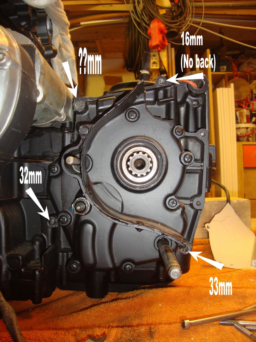

Im still struggling with a stripped thread in a mangled hole in a very difficult spot.Can anyone give me a depth for the hole as I really dont want to drill through the casing.
Top left;
Also,does anyone have a smart idea for getting a drill 'straight' onto the hole,I would appreciate it
Thanks
(J Model engine and damage to casing probably came from the sprocket bolt coming loose)

The problem he is having Steve is that on his motor that hole do NOT pass through. He is trying to get someone to measure the hole depth for him so he knows how far to drill so he can retap it. He has a "J" motor.
Davido, at this point I would go with the same depth as the one that does pass through, 16mm. Or go as far as the recess under that location. My thought on this is that there is not a lot of stress at this location. It does not require a lot of torque. All you have to hold is the new hydraulic clutch plate your building. It does not have any more pressure on it than the OEM set up, the hydraulic set up as to apply the same amount of pressure to engage the clutch as the worm gear did.
I agree with Steve that removing the starter may make it easier to tap and thread. Like Steve said, I would try just tapping it with the existing hole. Use cutting oil, make a couple of turns, back it out, blow out the hole clean the tap, repeat until its done. If you remove the starter you should have enough room to use a box end wrench on the tap.

Thanks for the reply Steve. The hole is clear but mangled,misshaped and oversize. (The PO had the bolt fixed in with silicone.) I cleaned it out,filled it with 2xcomp liquid metal and flattened it down. I got an extra long 6,5mm drill which fitted snug in the bolt hole in the original cover. With the cover in place,I was just able to drill a slight indent in the hardened liquid metal,Just enough to center the correct sized drill.
I have taken out the starter and the genny cover but the distance is still too long for a regular drill (about 14/15mm I think) .I was able to find a ( cheap) drill with a hexagonal shank along with a long bit holder I could get the drill on, centered and parallel. For some reason (low quality drill?) I was only able to drill in about 10mm or so,then I hit something solid. I didnt want to force it,so I left it like that.I tapped it out and fitted a Helicoil with some thread lock. Next day,I put the side cover on,tightened it down a bit and the coil pulled straight out!
Looking at the tap that came with the helicoil,the cutting part dosnt really start until 7 or 8mm in so my coil had nothing to bite on.
So,plan D is to forget about liquid metal and helicoils or timeserts. I want to drill the hole very oversize maybe M8 or M10,whatever I can get away with. Tap it,thread in an alminium bolt,whack it off flush and drill/tap that.It should be a lot more secure.
I want to go in as deep as I safely can,hence the question 'How deep should this hole be?'
Im pretty sure the threads dont go right through on this (J model) engine. On earlier ones I believe it does and I really dont want to run it as is because Im fitting an hydraulic clutch shfter thing so I need all the mounts.
P.S.Any Idea how deep this hole should be?

I just measured two blocks- 75mm deep
To get maximum threads, use a bottoming tap. They are more of a challenge to get started perfectly straight, but they will make threads almost to the bottom of the hole. Alternately, you can start threading with a regular, pointy tap, then finish with the bottoming tap.

Aha! I did wonder about that. There is a locator on the bottom right mount,would they put 2 on one cover??
OK,Just checked the parts page and yes,it seems there are 2 locating dowels on the cover but they seem to be on the bottom 2 mounts.
Which would explain why the lower right mount looks a bit big but dosnt help with the depth measurement I need
Thanks anyway.Good to know.

28 Jun 2015 12:18davido wrote: Could do but it would be a lot easier if someone just measured it and said,'This hole should be xxxmm deep'
Guess what, I just tore my spare J (GPz 1100) engine down this weekend - went out and measured, that hole is 22 mm deep.
And yes, the two locator dowels for the sprocket cover are on the bottom bolts, none in the hole in question.
