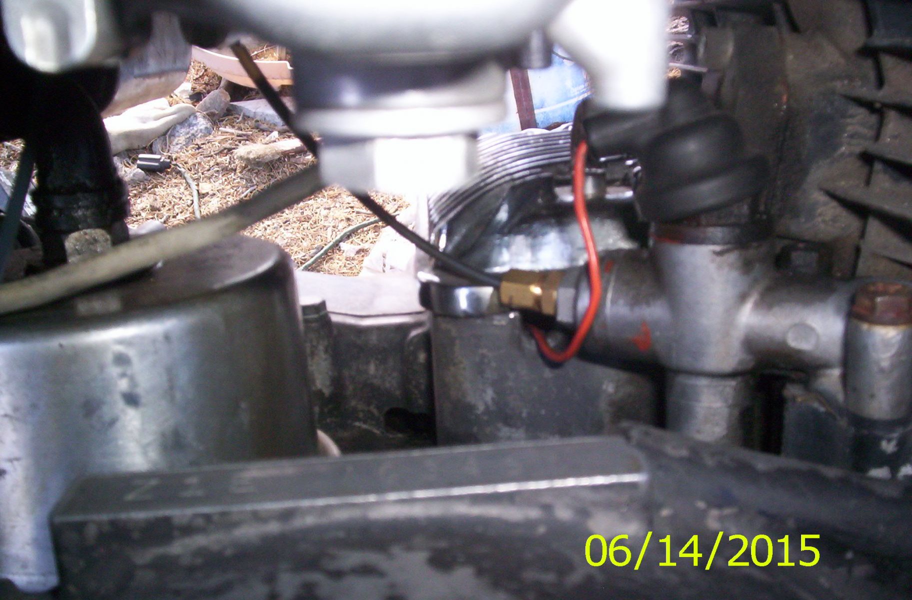

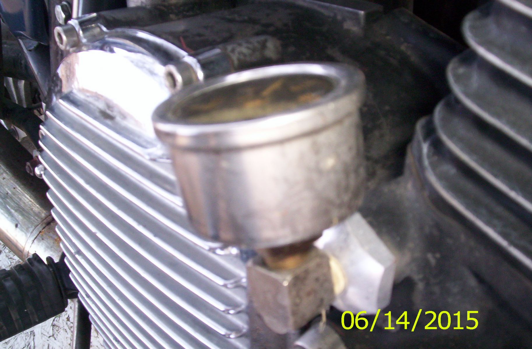

All I know is a standard gauge fits the oil pressure ports on the side and at the oil pressure riser behind the base of the head. If they're not NPT, they're damn close. Because of my fancy starter cover I couldn't fit a standard 1/4"NPT fitting in there. I had to drill and tap for a 1/8" fitting.
