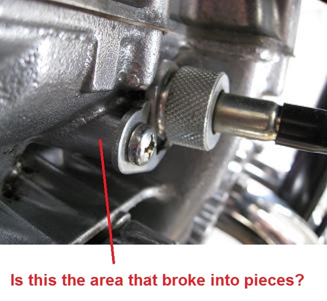

On this pic that 650ed posted almost 4 years ago, is the added red line pointing to the broken area?
Are any female threads remaining on the engine head?

I think that's what he was talking about. Must have been something more than just tight. I would suggest he buy a tap at OR or AZ, run it through and use a longer bolt. A little JB weld to glue the pieces together before doing it could work. He may have given up.

14 Jun 2015 06:53 - 14 Jun 2015 06:53For sure, don't assume anything. post up good photos --- the one Patton provided is pretty darn good.ezrider714 wrote: without pictures to asses the damage, everyone seems to be jumping to the worse case scenario :ohmy:
EZ
Electronic tachometer. The Kawasaki electro tachs I've investigated get their signal from the black primary wire going to the 1-4 ignition coil --- it's the wire that provides the signal to fire that coil.

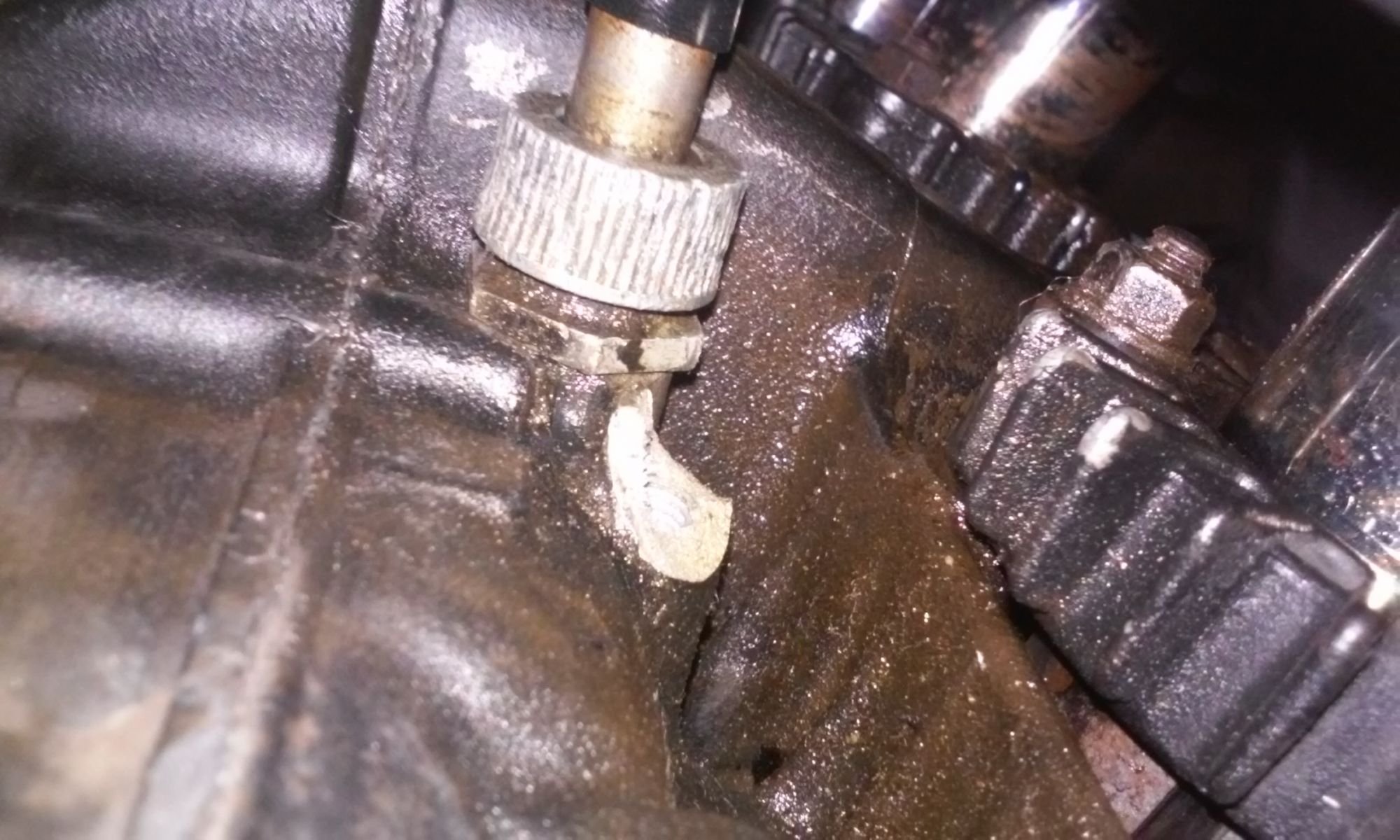

:huh:
Re: kz650 tach lock fork broken
17 Jun 2015 21:22
OK

Does that thing screw in? Is it tight? If not and it does, you can try blue lock tight on it.
